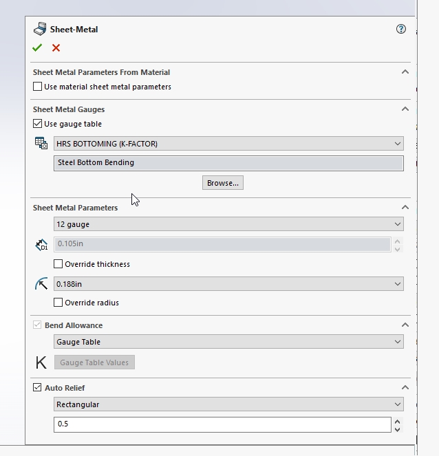

Thanks, jcapriotti! Apparently the solution is to forget about Bend Tables completely and use the new Gauge Tables for everything. They control material thickness, material alias (gauge name, SKU #, or nickname), available radius, and K-factor all from one file. Eventually, I will create a separate table for each material and process, although 90% of our work is HRS bottoming.
From the interface, select the appropriate table, the material thickness, and radius (if there is more than one available). The Bend Allowance type will default to Gauge Table but this can be changed to reference a Bend Table or to key in a K-factor.
Attached is the HRS table I completed this morning. It is not complete yet but it should give a general grasp of how it works. Thanks to all who helped with this!
