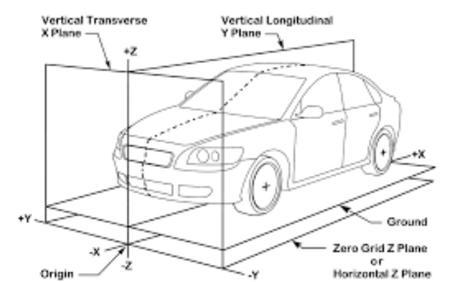

This is how the axis are related to vehicles. This also follows the Right Hand Rule.
If you stand in the middle of the front of the vehicle .. hold out your right hand .. your thumb pointing up. your index finger pointing to the rear of the vehicle, and your middle finger point to the passenger side of the vehicle, then all of those three fingers are pointing in the positive direction of the axis.

So should it be from inside the car looking forward, or in front of the car looking toward the car?
If you are sitting in the drivers seat. Then you need to use the Left hand rule.
Where your thumb points up for Z positive
Your Index finger points towards the passenger seat for Y positive
Your middle finger points towards the rear of the vehicle to X positive.
Middle finger should point up all the time …
