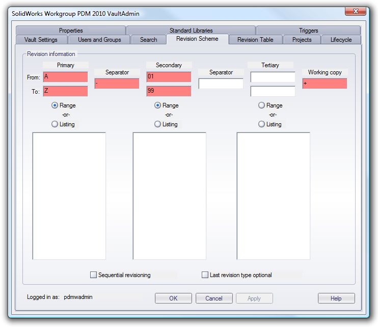

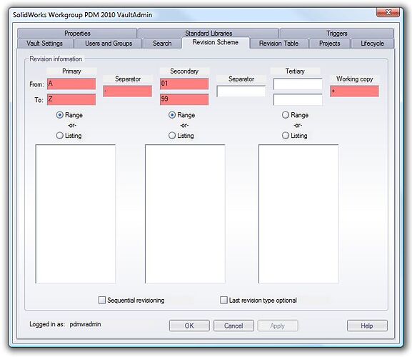

I just went back and found this. This is the setup page we had in PDMWorks which showed the Primary and Secondary revision schemes along with a Working Copy designator. This is maybe the piece you’re missing. The Working Copy designator allowed a rev to be overwritten every check in with a new working rev until you’re ready for release. PDMW was the kind of stuff you got for free with the Pro version of SW. So something you had to pay for has got to have this kind of functionality.
We are using a simple, single variable, revision scheme that is controlled by the PDM Workflow. The file starts life at rev 00 and the first time it is released it is 00. When it goes to WIP the revision on data card shows 01. Checking file in does nothing to the “revision” only the workflow states and transitions have an affect on the reivision.
I could be confused, but it sounds like you’re incremental revisions .1, .2 etc were for each check in? We don’t have that as part of our “revision” Solidworks PDM keeps a list of “versions” for each file. Every time the file is checked in with changes the version in incremented. So that sounds a little bit like what called incremental .1, .2, .3 etc. component of the revision
