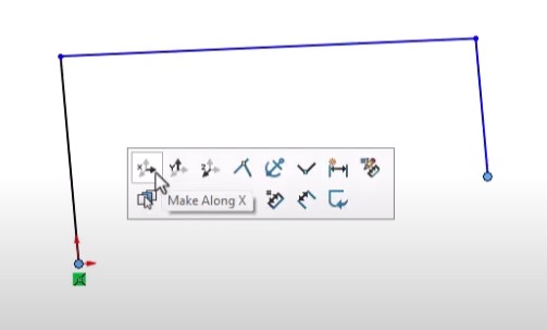

I’ve never seen that shortcut bar, have always clicked in the feature manager. So I played with it and couldn’t get it that shortcut bar to appear. Turns out I needed to release the ctrl key after selecting the 2nd point instead of continuing to press it. Or if I continue to press the ctrl key and then right-click the relations shortcut bar will appear.
It’s really interesting to me that there are so many conditions under which certain things either will or won’t happen. The Help just glosses over these things. Sorry I forgot to mention that one. I just do it instinctively, I think. Since the “context menus” have appeared, I’ve really reduced how much I rely on the property manager, although I still look through it for tricks or additional functions I’ve forgotten,.

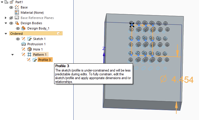

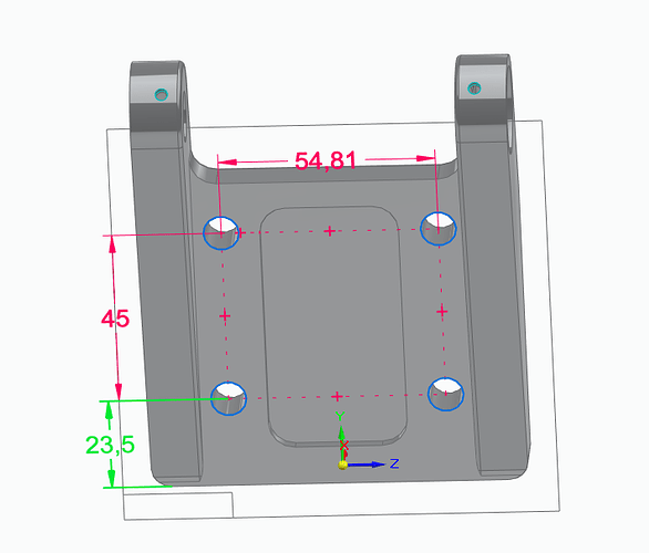

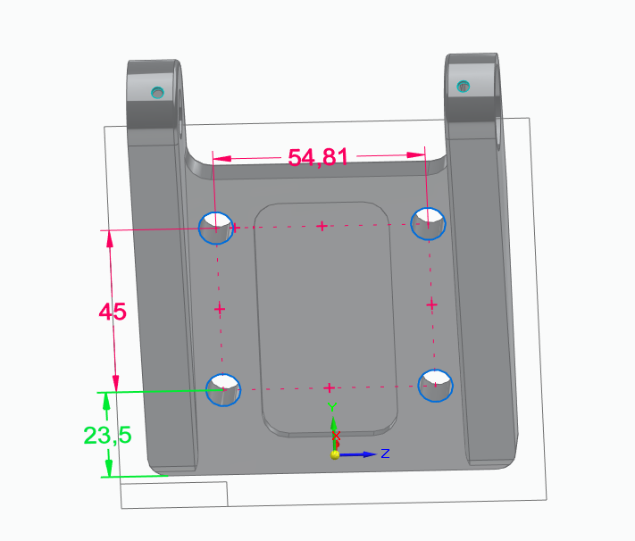

I have being following the videos especially to learn more about Edge. Could you possibly do one on the hole wizzard. I am finding the SE one infuriating to figure out. For example changing hole type and adding more of the same hole. Also in the screenshot below I can’t figure out how to delete the 23.5 dimension. Maybe this should be its oum seperate qusetion topic.
SE has just recently changed how they do patterns. Which version are you using? I think that dimension is held in a sketch. That’s part of the software I’ll have to research a bit before I can do a good video.
Thanks for following the videos. It helps to know there’s someone other than my mother watching these things.
I may have figured it out. Under the pattern there is a sketch. If you edit the profile, you’ll be able to delete that dimension. The sketch for patterning stuff in SE seems extremely hoky.
I have just installed SE 2025 CE. I was not actually using pattern. I would go into the hole wizzard and pick for example M8 c’bore. Then in the sketch placement I would put multiple copies of the hole like one can do in SW, add dimesions and symmetry constraints etc.
