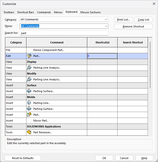

Edit Component - we all know how annoying it is that you can’t assign Edit Component / Part command to a keyboard shortcut or mouse gesture. But you can with this macro. Select face / feature of any component in the assembly, and it will enter Edit Component mode. Run it again without anything selected, and it will exit Edit Component mode.

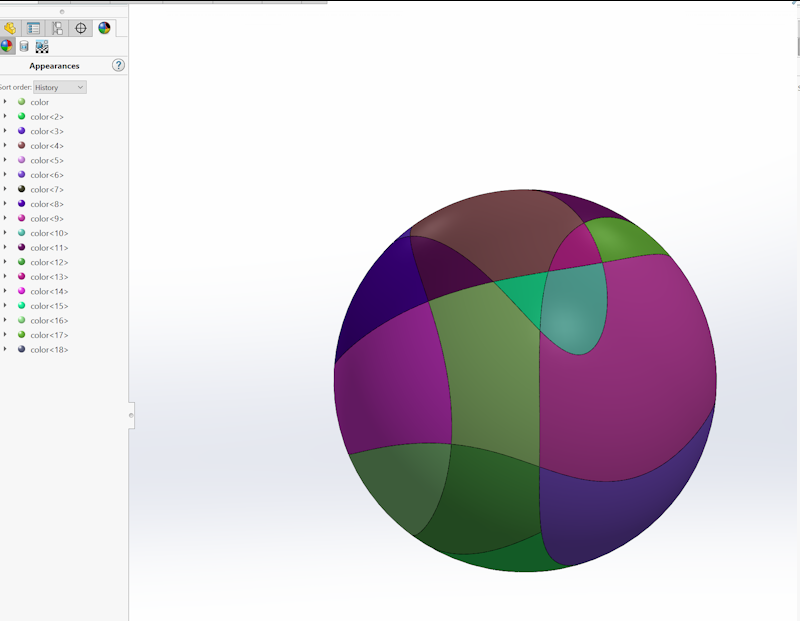

Random Body Color - randomizes the color (appearance) for every body in a multibody part. Useful with complex geometries where the boundary between bodies might not be clear, for example after complex splits. Also very refreshing for the eyes once you get bored by the default grey. Works both with solid and surface bodies.
Thanks laukejas It has already been put into good use. Clever one!
FYI, you can set a hotkey to edit a part, but it doesn’t work for editing the selected assy.
