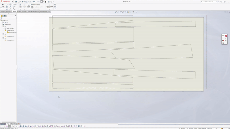

Sharing one more macro - automatically positioning drawing view by a selected point. Useful when you need to align a layout with the sheet corner for 1:1 template printing, aligning two drawing views by specific geometry, etc.
The way it works:
  1. Draw a sketch point (*) in the drawing view you want to align;
  2. Select that point;
  3. Run this macro, enter the desired coordinates for that point, and click Set.
(afterwards the sketch point can be deleted)
