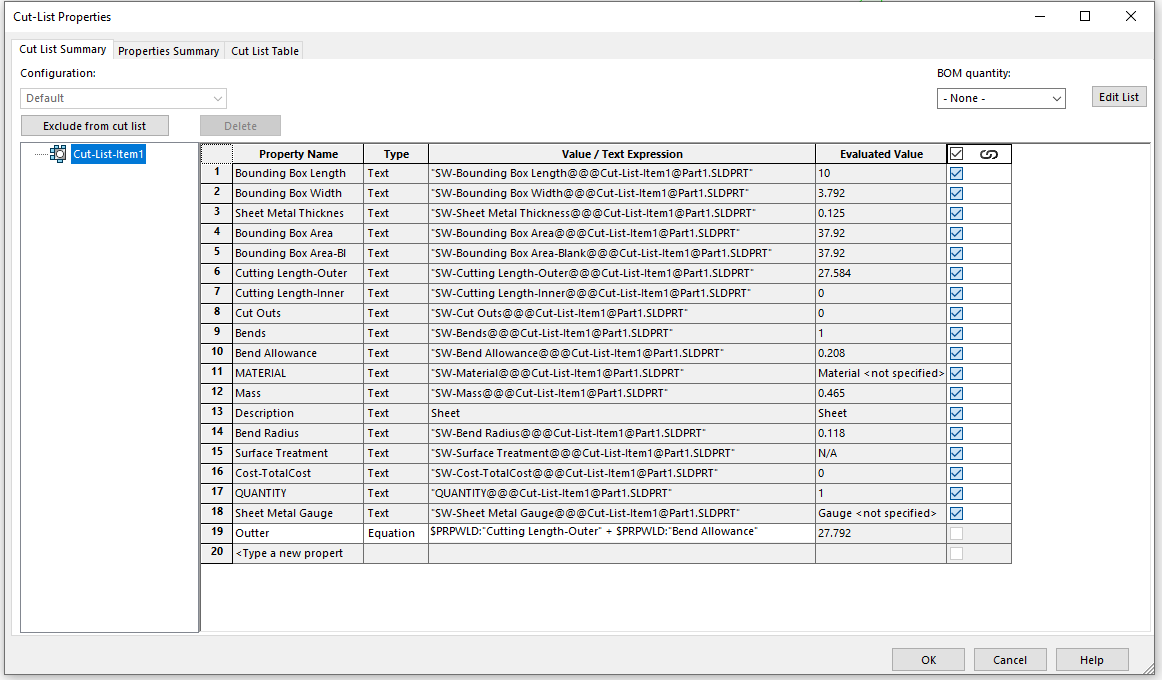

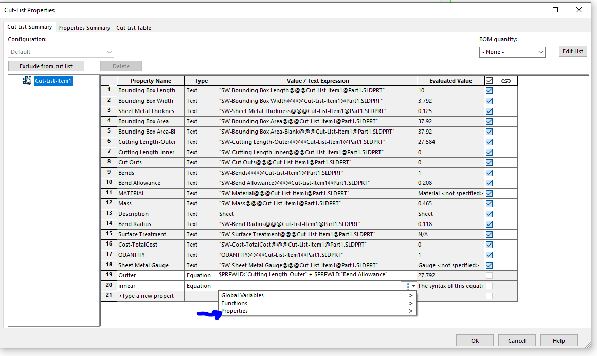

I believe the thing it does not tell you is you need to use the drop down under Type and select equation to add the fields together.
I added cutting length outer and bend allowance. 27.584 + 0.208 equals the 27.792 value shown
When you select equation for type you get a list of the cut list properties show up when you click the box
I was able to pull the numbers out of the cutlist, and “add them together”, but as per your example mine says 27.5840.208. If I go to the properties, I can select “Equation” from the dropdown, and it will add them together. Question is, how do I get the Type to be “Equation”, not “Text” within the macro?
