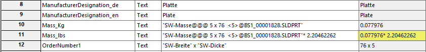

Is there another way to output the weight in pounds instead of kilograms?
There’s not a clean way I can come up with. You can use a Design Table to do the math and get that output into a Custom Property. Dirty, but it works.
I attached a file with it done with configuration specific properties.
You can not have the values multiplied in the custom properties but only in equations. So you need to add an equation and link the property with that. Here is an old post on same topic https://gupta9665.wordpress.com/2011/06/26/display-mass-in-dual-units-in-solidworks/

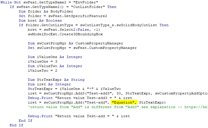

I have found a solution!
If you use the oldest version “Add” instead of the newest method “Add3” it works!
The difference is due to the different declaration of the variables for fieldtype.
With “Add3” it is in VBA a variable of the type “Long” or selectable over an enumeration.
With “Add” it is in VBA a variable of the type “String” where I can enter what I want.
A first test with the old method was positive for me!
Gold star for you sir! Way to dig back through the archives! You may want to inform whoever told you there is no workaround and rub it in their face… :laughing:
In case anyone can help, I’ll post my solution and a demo file here. I have tested the workaround with SWX 2021 SP5.1.
It is important to adjust the string for “equation” to the respective language setting of the menus.

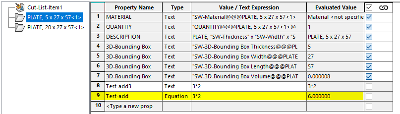

![2023-01-31 11_18_59-Microsoft Visual Basic for Applications - AddCutlistProperty - AddCutlistProper.png|733x450
After running the macro, the properties of the end cap contain the equation
