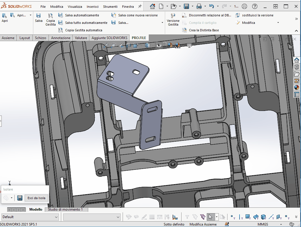

I really don’t understand why they don’t incorporate the ‘flip-alignment’ and ‘lock-rotation’ function in the ‘in context’ toolbar as alredy available in the quick-mate using ‘ALT+drag’. Click on the gif images below to show animations.
