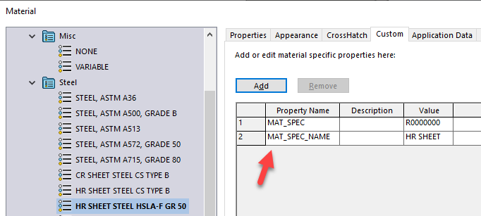

Our shop doesn’t see the Solidworks material name. The material in SolidWorks is based on an engineering material specification document that could cover a range of material form factors. This number and it’s description is added as a custom property in the SWX material database. We pull these values with the API to apply it to the regular custom properties.
The factory might have have several material part numbers for this material that is added by them in the Mfg BOM. For example, for the above “HR Sheet grade 50” they have different gauges and even different stock sheet sizes (36x48, 48x72, etc.). This is done outside of SolidWorks in the MBOM.

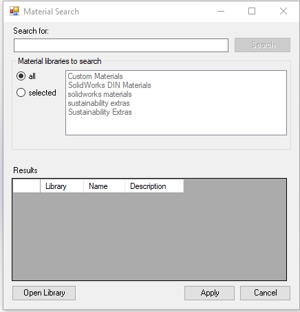

I whipped up an add-in that will let you search for text in the material name or description. The basic building blocks are in place but I 'm curious on how you would like it to work. Would you prefer a tree structure that narrows itself down as you type your search terms like the current name search does? The problem with that is that if the tree lists just material names and a description matches, it might not be obvious that it’s a correct match. Another option is to simply have a search form that then lists the results in a tabular form showing name, description, etc and then you could select from the list to apply the material.

Yes. As a SOLIDWORKS add-in it can be a menu item, toolbar button, etc. I played around with having it pop up when ‘Edit Material’ is selected, but the results weren’t satisfactory (two dialogs showing, one dropping into the background). I haven’t given up on that approach entirely but I suspect it isn’t doable.
Actually it is quite doable. I just needed to read the API docs more carefully. Edit Material now brings up this dialog:
And search results look like this:
So…progress.

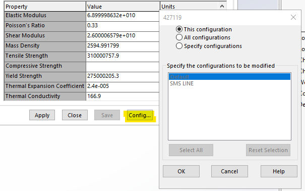

It is C#. I’ve got the dialog all working correctly. Next is to pass the info back to SOLIDWORKS to apply the material. I have to do a little more work to differentiate between applying to part/bodies and to handle applying to current config/all configs/selected configs. I’ll probably add another button to the form that works exactly like the one in the SW dialog:
