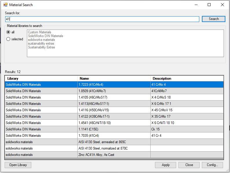

This is what the search should look like. Take a look, SolidWorks!

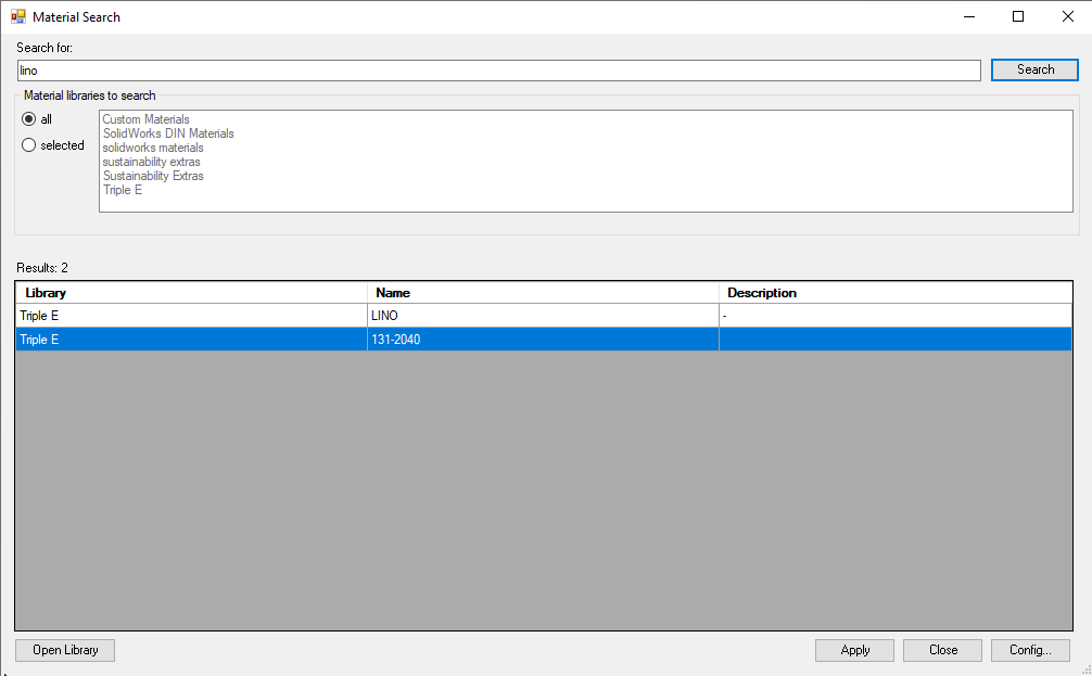

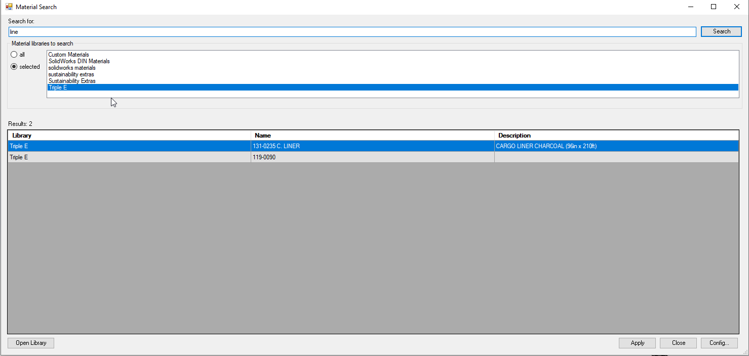

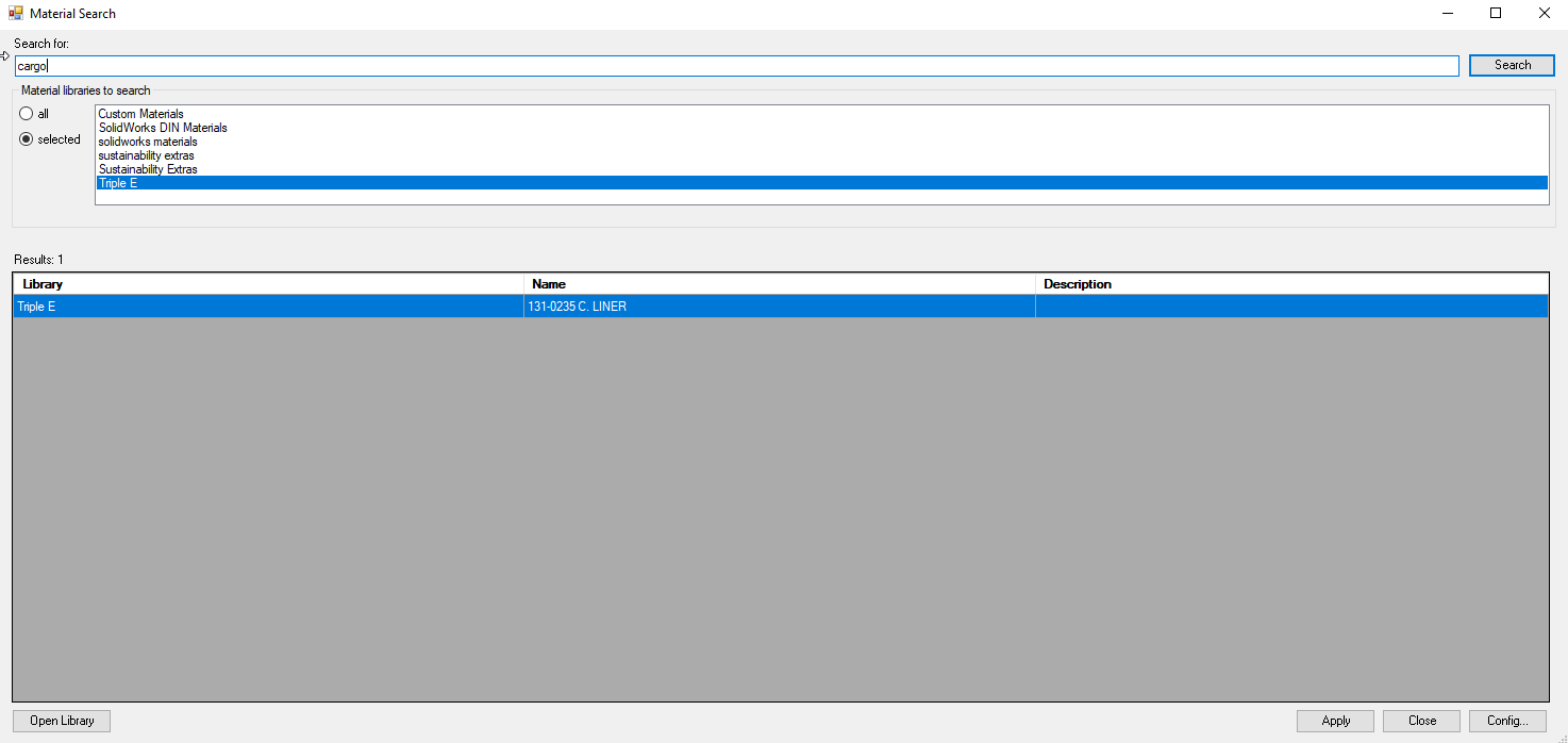

some more weirdness that might be useful for debugging here:
If I search for the description differently it will show it.
Description shown:
Description not shown:
OK. I’m pretty sure I know what’s going on there. Should be a quick fix.

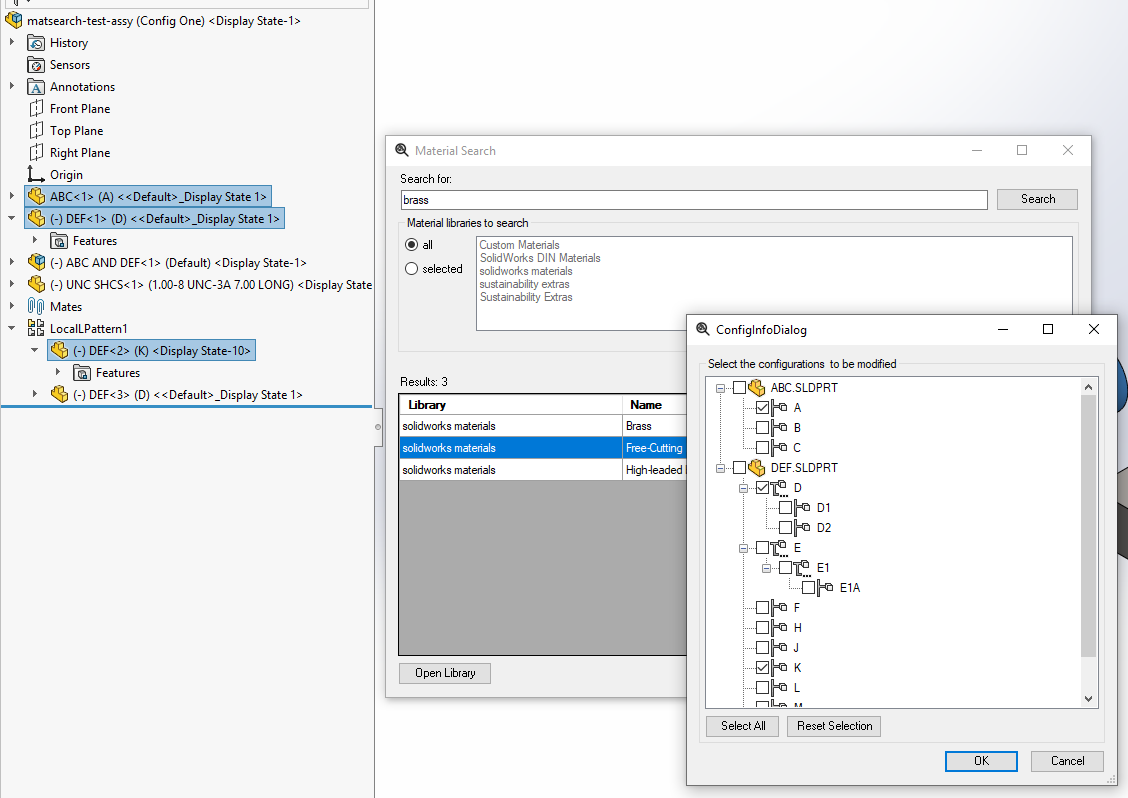

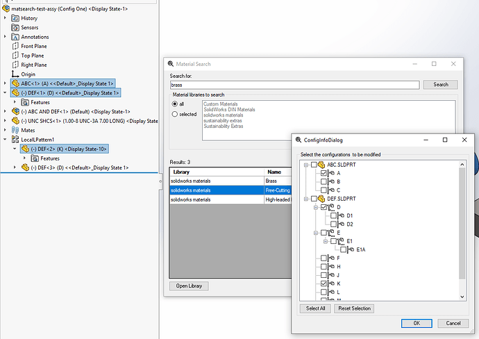

How about a tree like this for a solution:
The default is the checked config is the configuration in the assembly of the selected component. Checking the ABC.sldprt checkbox applies to all configs. Otherwise, pick and choose.
I love the tree option for this one - especially if you have nested configurations.
