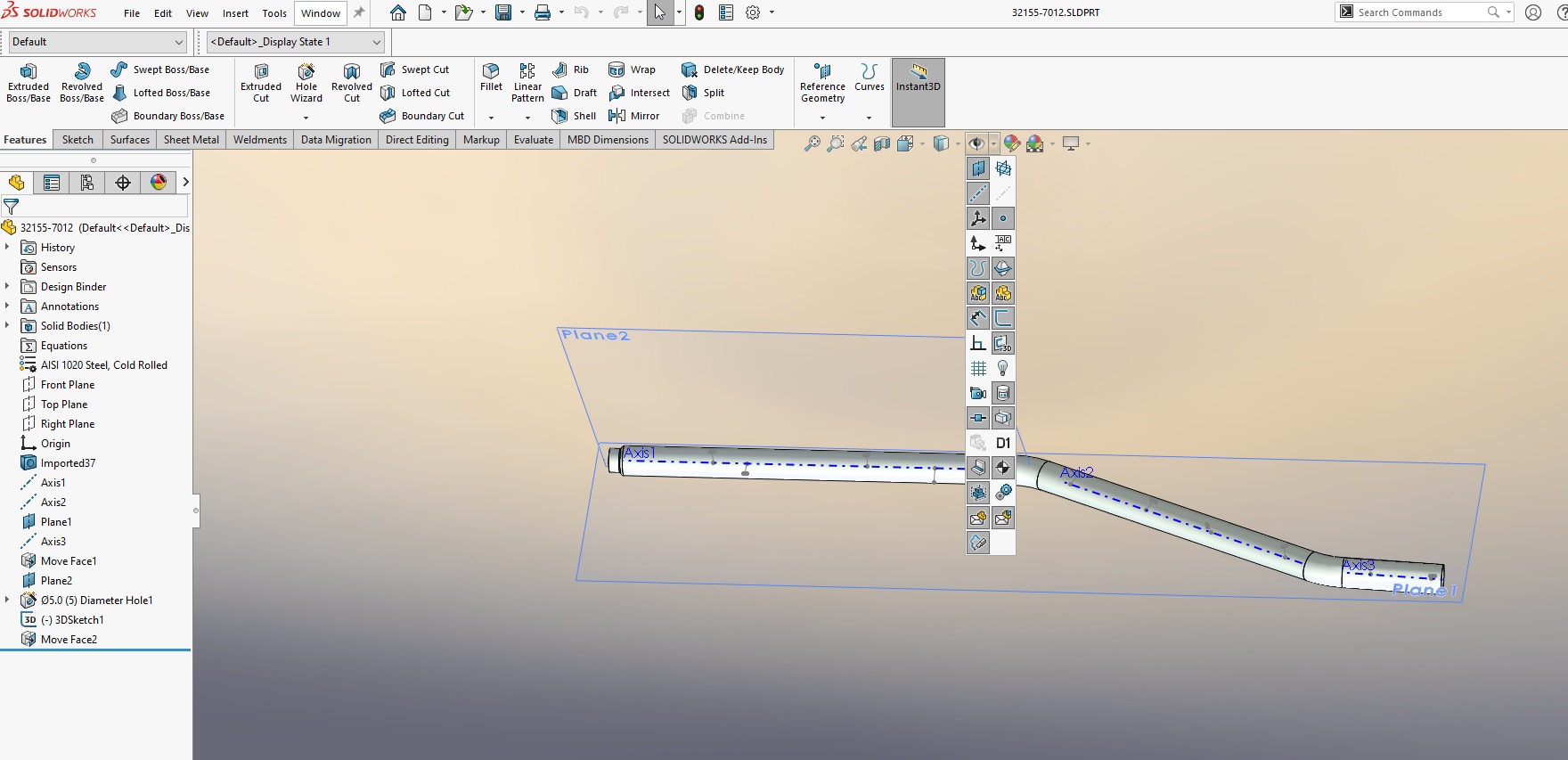

It works fine for me. See the screenshots below. I created a new display state and set the Plane to show. When I switched back to the original display state the plane doesn’t show. Maybe I wasn’t clear though. You need to have manually hide or show the planes, sketches, etc in each display state. That won’t happen automatically.

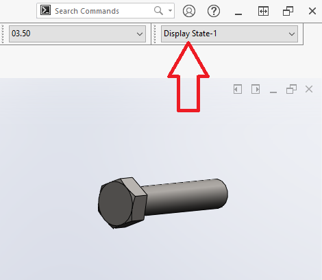

I am able to control the active display state of a component (such as hide THIS sketch here), save that component, and when I return to the assembly that sketch is hidden while others are shown. It is a layered structure. Control the parts and you will have them show nicely when in assembly. Control the varied displays you want in the assembly to have them show nicely in drawings or exports. They can be useful in direct context, but are more useful to reference in downstream applications.
OTOH, your assembly display states can control those entities but only with the same tedium as manual fussing.
That’s why I think that it’s something you can adopt into parts so that you have planned ahead for its use in the assembly. This does not in any way help you now that you are already in the assembly unless you want to add extra work to go back and alter your components themselves.
To be more specific, you can select and control the Referenced Display State of a component within its Component Properties. This does not go back and create component display states for you here, but it does allow you to leverage the decisions you have already made in the past.
