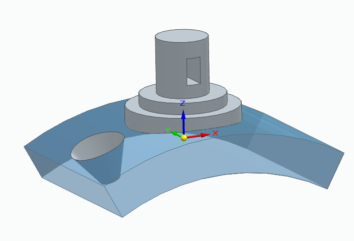

Like this?

Something like that ?
probably would do, but the hole should be constant size and the key part should extrude outwards from the middle shaft, until the rounded edge of the lower/wider ring in the bottom (and should touch the ring too, not be in the middle of the shaft).

I have pm an example (done in community edition).
If you can draw a 2d section view version of it I can model it up for you.
But general rule .. if its round its convenient to use revolve in other cases normal extrude.

Okej .. throw something together at work ..
https://youtu.be/gqCopuhIX7o
ok thanks, thats pretty neat, but they key part should be exactly like it was at 02:19 - and just touch the edge of the middle ring below it and end with the same shape too, aka follow the rounded edge of the middle ring
