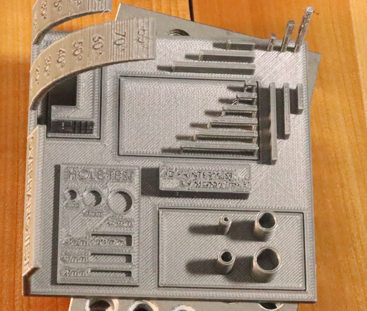

I liked the Bambu Carbon so much I bought one for the house. Over the past few weeks I’ve been printing that sample part on the bambu, as well as the other printers at my disposal. Last night I spent a good bit of time taking pictures of all of the samples, and the conclusion is I am not a photographer. :blush:
The Bambu is by far the best of the 4 printers I tested. (Creality CR-10, Raise3d N2, Raise3d E2)
The raise3d printers are old and tired, and it showed in the test parts. These printers will be replaced by a 2nd Bambu carbon, if we reach the point that the current printer can’t keep up.
The cr10 was pretty good, all things considered. It also has a lot of miles on it, but it has many upgrades from a stock cr-10.
I tested several different print settings and filaments on the carbon. There were minor variations between the prints, but they were consistently good.
The overhang tests are where it performs the poorest, and then only at the end.
There is some very fine stringing on some of the prints at the bridge and the tower locations.
I can’t say how it compares to a higher end machine, but the Bambu Carbon easily outperforms any machine I’ve personally operated (which includes a few more than what is listed above.)
If you are interested, I can compile all of the pictures and relevant printer/slicer/settings info. It will likely tell you more about my photography skills than the printers. I can even box them up and ship them to you. I am curious how the quality compares to an Ultimaker.
