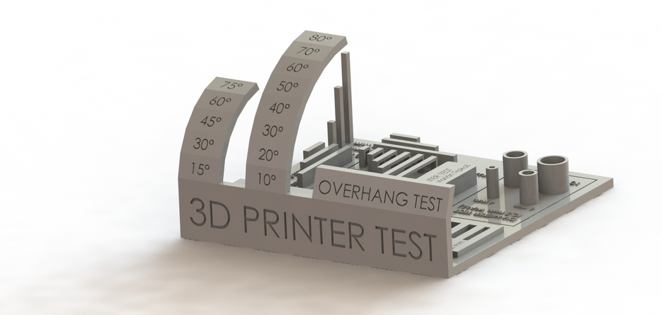

Also how does a model like this print?
https://www.thingiverse.com/thing:2656594/makes

I have no idea. I don’t need to print anything that looks like that.
