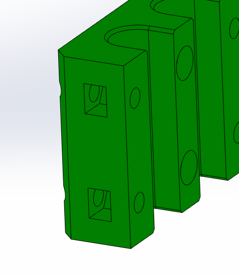

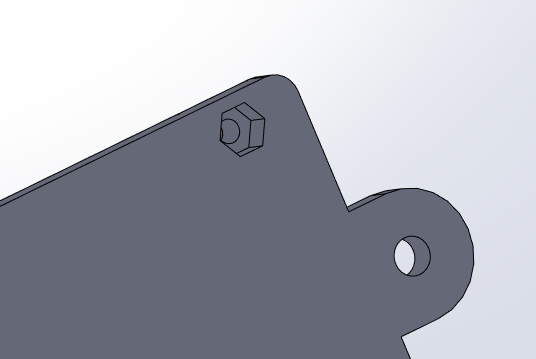

I try and avoid using captured nuts whenever possible. Instead I will leave a pocket to insert the nut. I don’t have to baby sit the printer (or worry about stopping the slicer at the proper height) and if a nut ever gets damaged it can be replaced.
https://www.youtube.com/watch?v=KVf0mbBCygQ&t=19s
I did the same. Keep the hex pocket a bit tight to keep the nut in.

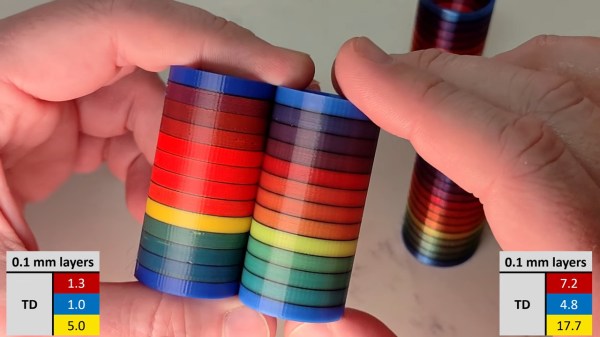

https://www.youtube.com/watch?v=hfy3Dl0R-lA
We might only need CYMK to print full colour.
Time to upgrade my 2 nozzle to 4.

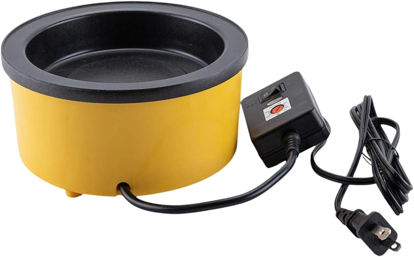

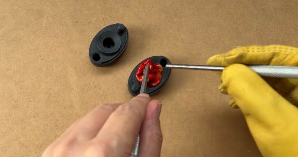

I didn’t see what material was used for the mould. ABS? ASA? Something that won’t soften below 200C. Good to use up all the poop.
Hmmm laser cut/engrave wood or acyclic.
Melt and pour.
