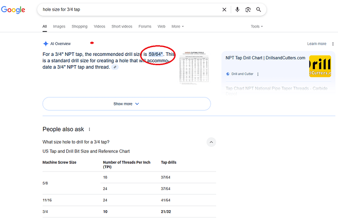

I’m modeling up some custom bushings for another department, which is something I don’t usually do, so I asked Professor Google a question. Without thinking about it I used the first thing I saw, not realizing it was the AI answer.
Next time I’ll pay more attention.

NPT is a tapered pipe thread. So if your prompt included the “NPT” and this is the response then I’d say it’s wrong but more specific.
When I asked for the hole for 3/4 NPT tap specifically, the answer was
For a 3/4 inch NPT (National Pipe Taper) tap, the recommended drill size for the hole is typically 0.750 inches (19.05 mm). This size allows for the proper taper and thread engagement when tapping for NPT fittings.
I am guessing that’s still wrong? :slight_smile:
Deepseek says:
Recommended 59/64"(~0.9219in) (23,4mm)
Alternatives 15/16" (for harder materials) and Letter Size Q(0,9210")

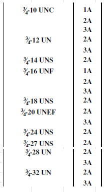

In AI’s defense, your question was rather vague (from Machinery’s handbook):
