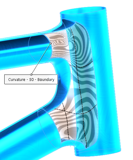

I’m curious to know who else is using this? At the time we got it we had Creo and Style (ISDX) . There were cases where we struggled to get decent surfaces in Creo that Xnurbs produced the goods. The only benefit in using Style over xNurbs was the live feedback on the surface that Style provides.
It did take a couple of versions to get right but honestly, this little add on is what keeps me using Solidworks. Like all surfacing it isn’t perfect. But it is damn good. Regardless of what they say, it is a kind of supercharged Fill Tool (which is still one of my favourite Solidworks tools), but with the added benefit of not being a pain to use sometimes.
XNurbs isn’t perfect of course. The Solidworks surface tools don’t like playing with it that well (so the solution is to ensure all your G1 and G2 linked surfaces are XNurbs - G0 you can use the driving curves). The licensing is a pain - don’t expect to move licenses around by activating and deactivating.
But for the money (we bought it on the pre launch offer) - and compared to what we were paying annually for Style for Creo, it was a bargain. one of the very few add ons that actually Added genuine functionality to Solidworks, rather than simply automated things it could already do.
If you do any surfacing related stuff in Solidworks, give it a try. It won’t work for everyone, but when it does it has the same magical “get out of jail” capability as fill did.
It’s powerful and V4 made it become useful… I’d consider it but, I found I can workaround or get what I need using other methods and imho, it’s still too expensive (for a one person shop). Although, some of his surfaces are very clean… wish we had those additional boundary controls natively.

WHEW this is a tough one. xNurbs vs PS. Honestly the upside to xNurbs is the control over curvature continuity which generally doesn’t exist in subD modeling and that it is NURBS and not a mesh means there’s no conversion needed. But of course the exception to this rule is PS because they do have some very capable options that offer a two way street inside of Solidworks. Meaning that you can bring in SW geometry into the PS environment and use it as a reference to then get the curvature control that’s similar to xNurbs. Once you “exist” from the PS environment the SubD will then convert to a SW surface. In this way PS does have kind of a leg up on xNurbs.
That you can do the “infamous”… “Y” modeling technique with xNurbs is amazing to me and that it’s not in SW is just horrible ( to put it mildly)!!!
SW can do the Y technique, but not with the gaps the way xNurbs shows. Paul Salvador showed the technique on his website at least a decade ago, and I learned it from him and it has showed up in my books.
