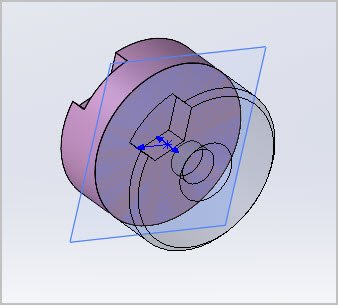

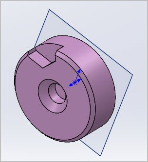

I’ve made this dummy example to ask my workflow question. The grey part represents my left hand master part. I made an assembly from it & mirrored about right plane using ‘opposite hand version option’, which yields the pink part. Now, going forward, any change I make to grey part gets reflected in pink part. So far so good. But I need to introduce pink part into a completely different assembly, with its own mates etc. I cant seem to save derived pink as a standalone part. I thought there was a way to isolate, which broke links, but even that does not seem to be asking me for a new part name. So maybe related to the mirror function itself?

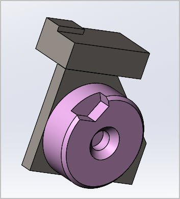

As a workaround I inserted the grey+pink sub-assembly into a new assembly, suppressed the grey part & seemed to successfully use any of the normal mating commands on pink. But that seems kind of clunky solution because grey part is always embedded there behind the scenes. Any suggestions?

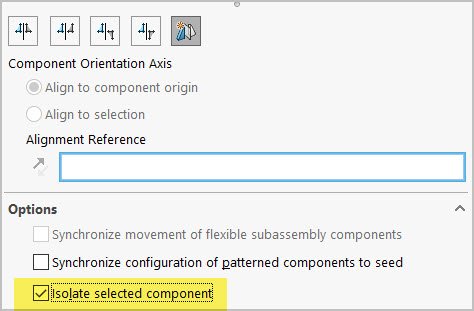

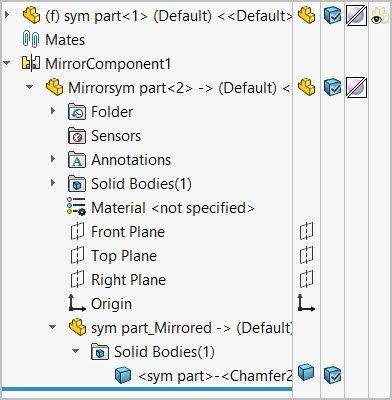

I think SW saves it as a standalone automatically, with the mirror feature. You can check the properties of “Mirrorsym part” to check the file location…
Looks like I missed this check box during the 3-step mirroring wizard. Nothing really happens until you save the ‘mirror generator’ assembly then it kicks out a part. But I was able to open the mirrored part standalone or apply it to another unrelated assembly or make unique drawings etc. So I guess problem solved.
