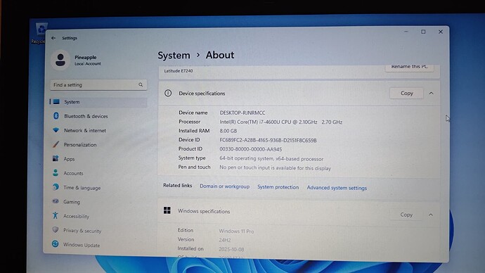

Used Tiny11 on my 4th gen i7 laptop, no TPM2.0:

I used Tiny11 to remove features and hardware requirement from MS 24H2 ISO file.
Rufus to make bootable “disc”.

Regular. Win11 Home and Pro ISO download from Microsoft.

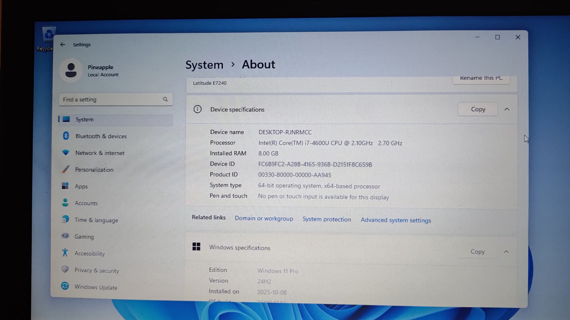

Updated another 4th gen i7 laptop to 24H2.
Then updated both to 25H2.
Ran Fusion on both.
