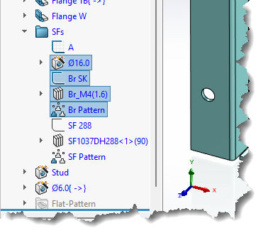

In case of my problem maybe the following image can show you what I’m trying to do.
I have two Ø16.0 holes and one library feature (bR_M4). The library feature is sketch patterned (Red ellipse).
Now I’m trying to sketch pattern the Ø16.0 holes and both library feature with the green ellipse (A Sketch).

The problem is your reference sketches for the patterns, you have a sketch point at the original hole location, only the instance locations need sketch points.
I deleted the points, which wasn’t easy as you had dimensions and relations to them that had to be reconnected.
