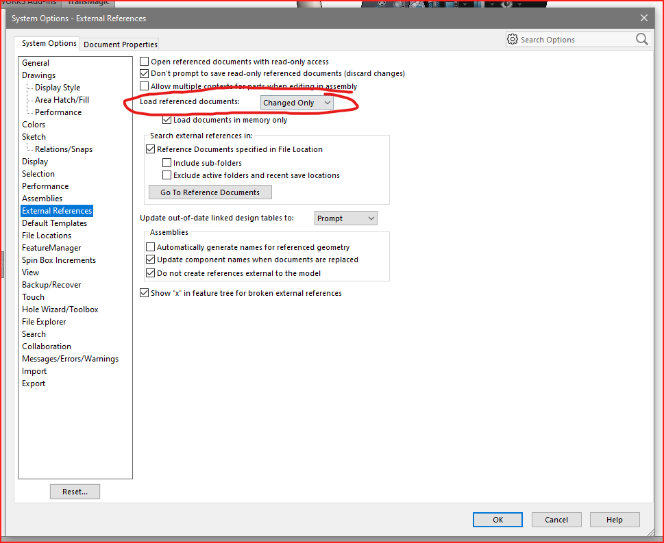

Set the option to open external references read-only. Take write access only when you need it. only save deliberate changes.
Also helpful to set collaboration mode so it’s easy to toggle read-only/write-access

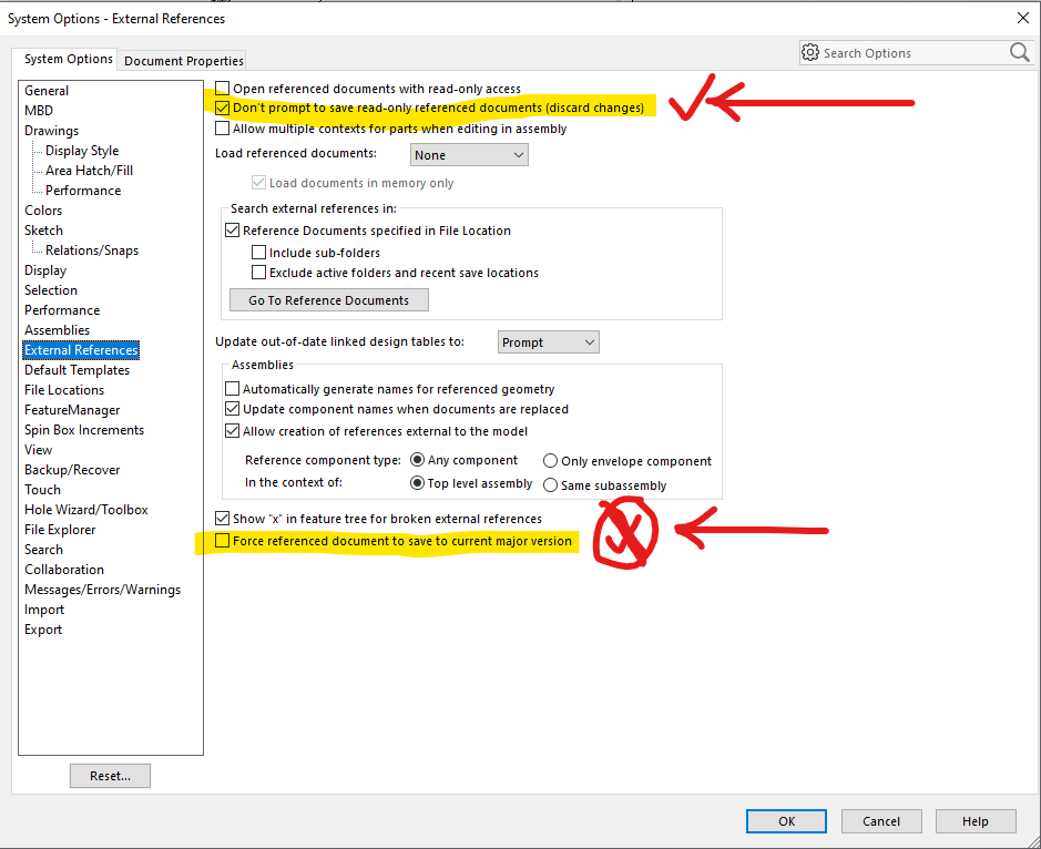

I’ve hated this for years. I think I finally solved it, at least for us:
In Options–>System Options–>External References, see below snip (check the Don’t Prompt to save read only… and UN check Force referenced document to save…)
Made an account just to add this, so I can find it later.
