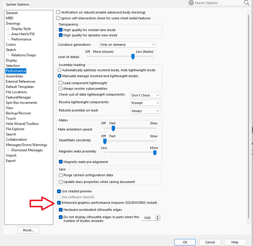

Why don't things look right on my screen?
First, go to Tools > Options > System Options > Performance. If the option indicated below is turned on, turn it off. I’ve seen a wide variety of issues reported with it on, and I haven’t seen or heard of any ill effects from having it turned off (I’m not saying there aren’t any; just that I’m not aware of any).

For the last couple of years, disabling “Enhanced Graphics” has been the answer to the majority of these questions.
Yes, I know. That’s why it’s the first thing I said to check above.
I searched the post for “enhanced” and it didn’t show up. (Obviously I didn’t bother reading your post.) :frowning:
