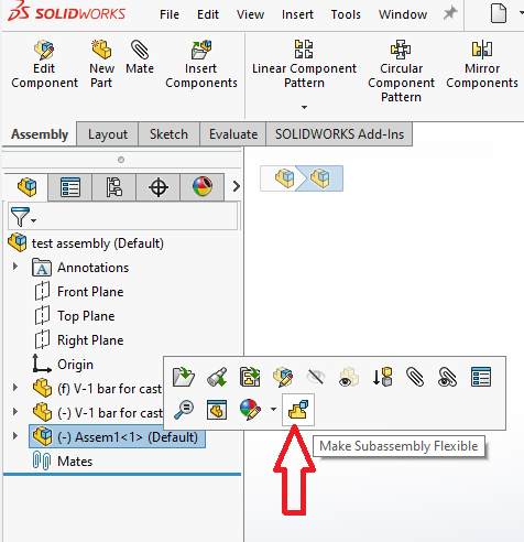

Click on the sub-assembly in the main Assembly tree and select the icon shown below. That will allow it to have the same amount of freedom it has in its own file.
That icon hasn’t always been available, so if you’re using an older version of SW and it’s not there, you can still get there.

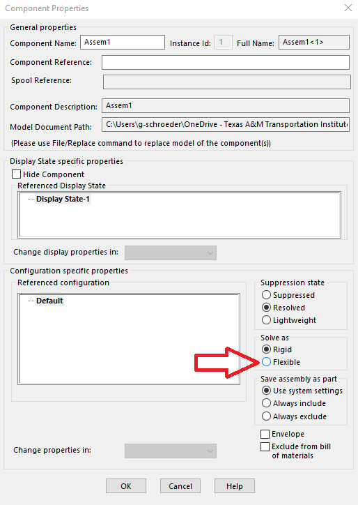

Select the Component Properties icon instead . . .
. . . and select “Flexible” under “Solve as”.
