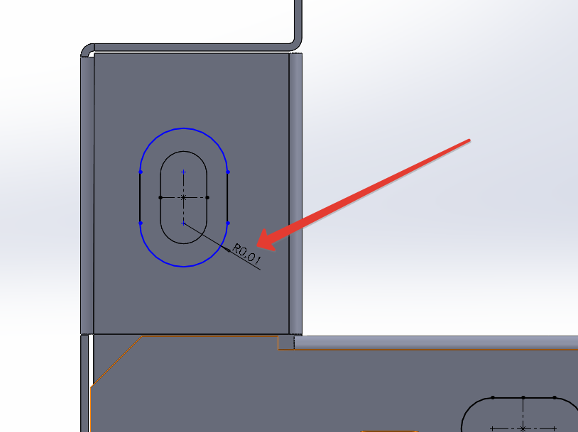

A problem i have had many times, i run into when working on step files. The dimension numbers are weird, when I double click and open the window, I can see the dimension, but other than that, the numbers are hidden.
Has anyone encountered this before?

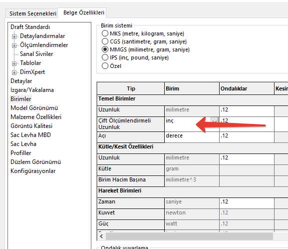

inch was a millimeter error, it was fixed when foreign step files (usa) made inch inches to millimeters.
