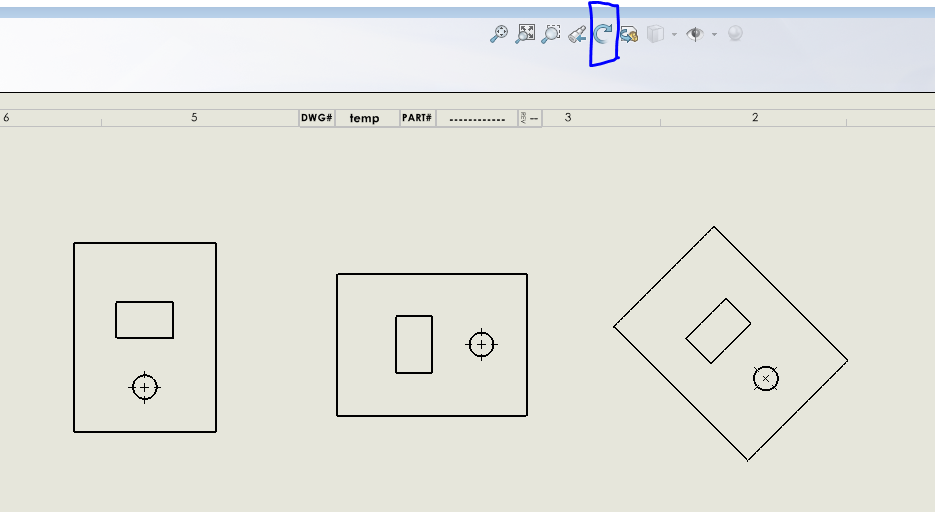

Where to “ROLL” a view and why is it different?
Starting in the assembly (..sldasm) and looking straight on to the front view and doing “this” (above in yellow) to roll the view 180 deg, everything looks good, you zoom in and show hidden lines and all and all looks good, it rolled the view 180 deg just fine. So I save that view as a saved view in the assembly (call it “180degrotate”) I make a drawing and drop in that “180degrotate” view and think all is OK BUT it is not! the view turns out to be OFF by:
360.00 - 359.96005626 = .03994380 degrees!! in the drawing

On the other hand dropping the assembly view looking straight on to the front plane into the drawing and THEN rolling the view in the drawing 180 deg makes the rotated view perfect!! in the drawing. Now why is that???
Typical SW. Just good enough LOL Nobody can see the different.
There are other ways to do it exactly, I think.
My guess is that, for each click of the arrow key, there is a XYZ possible deviation that is associated with it. In other words, each click of the arrow keys is a separate rotation, complete with its own potential deviation It might be extremely small. but it is still there. These add up.
If you have a bigger number here, it would lessen the number arrow key clicks.
However, when you specify the degrees in the rolled view at the drawing level, then there is only 1 rotation.

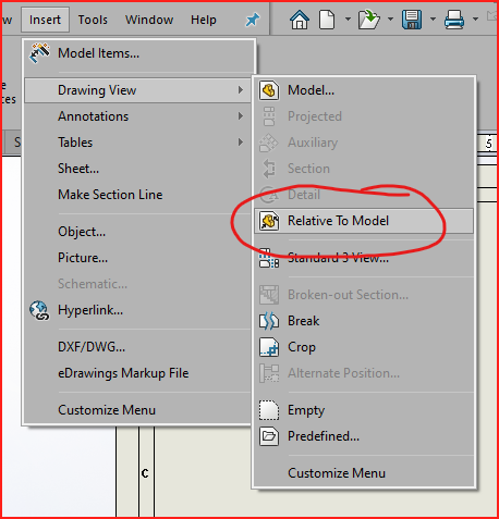

Personally, I prefer the “relative to model” approach for inserting drawing views.
https://help.solidworks.com/2018/english/SolidWorks/sldworks/c_relative_to_model_view.htm

. . . or click on a face, hold down Ctrl, click on another face, then go to “Normal to”. That will orient the model with the first face at front and the second at top. Save that view and reference it in the Drawing.
Glenn,
Good idea, and I tried that on a test model/drawing
But until I added the Flat it did not go upside down.

Rotate the drawing view, not the assembly.
Same front view rotated 45 and 90, but you can pick any angle.
