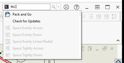

So I saw this post & new that I had edited the heads up view in the past & had to do some searching. Don’t know if this is correct or not but try this. Use the “S” key to bring up the shortcut toolbar and search for “pack & go” there.
Add it to your “shortcut toolbar” and then drag it to your “heads up view”

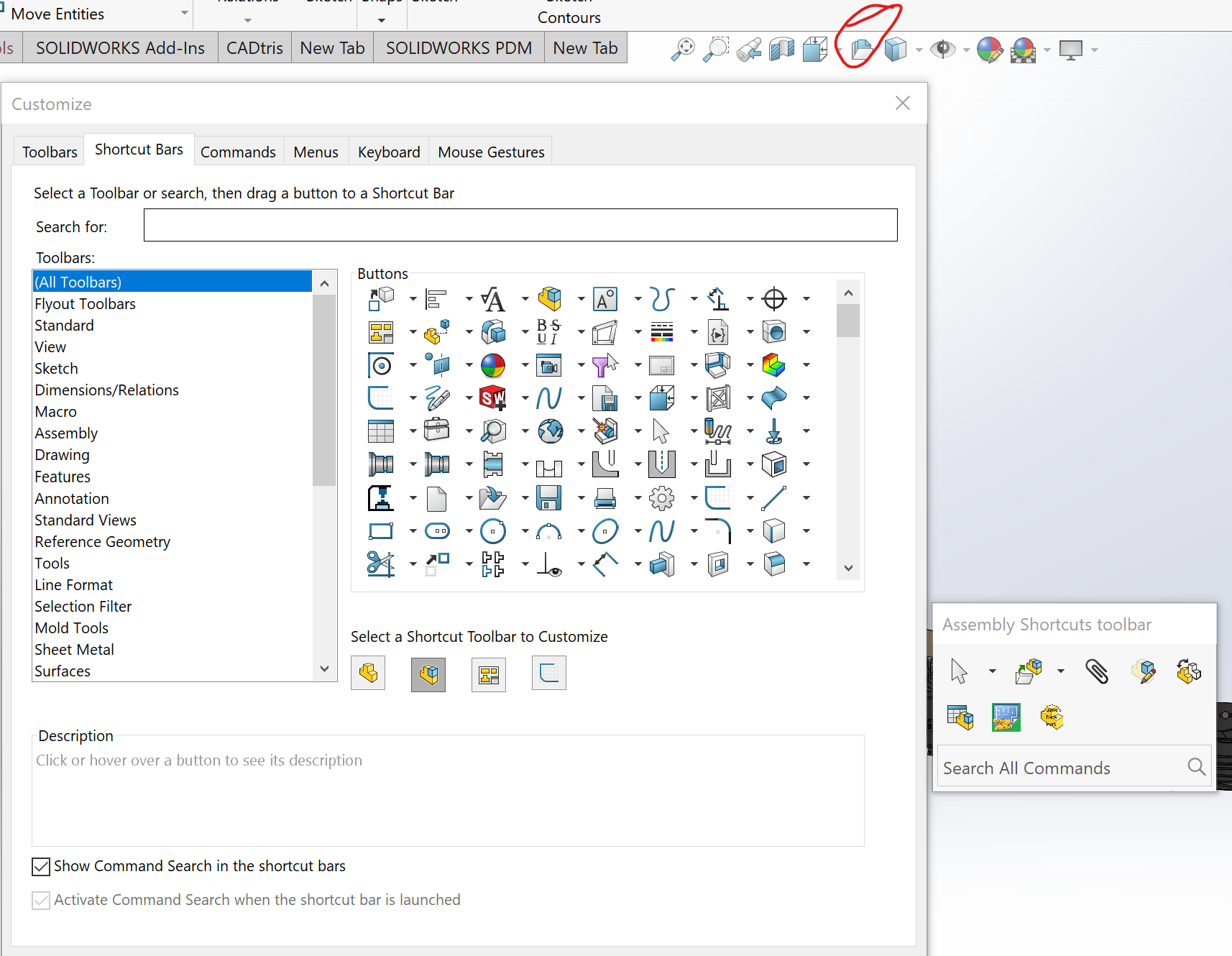

You will need to go into “Customize Shortcut Bars” to drag from the “Shortcut Toolbar” to the “Heads Up View”

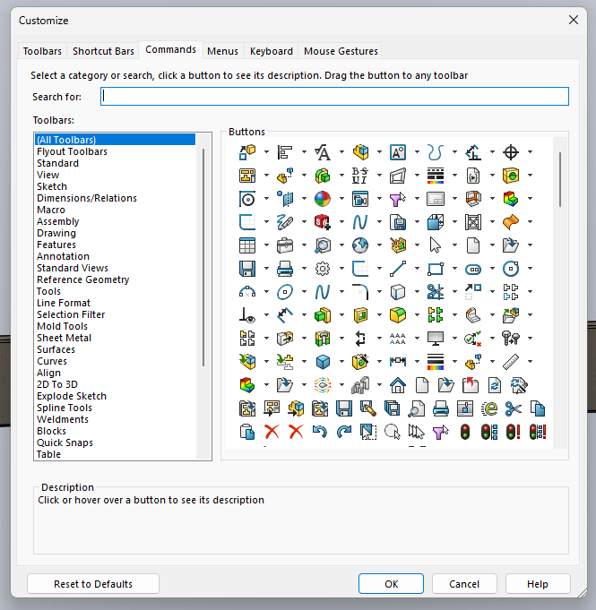

No problem. Glad I could help. But I was puzzled cause it couldn’t be found by searching in the “Customize Toolbars Tab” and yet when I searched in the using the “S” key it would find it! (But it was accidental several weeks ago, that I discovered you could drag an icon from there to one of the other toolbars!)
Thanks again. By the way, after putting it in the heads-up toolbar I remembered that I had had it at the very top of my monitor. I was able to go back to Customize and drag it up there.

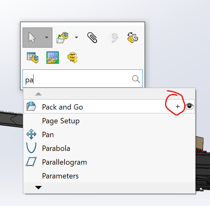

Any time I am looking for a command I go here
If the eye ball shows up you can click on it and let go of the mouse and watch it find the command for you.
The other thing is that you can drag the commands to your command manager tabs from there and create a custom layout.

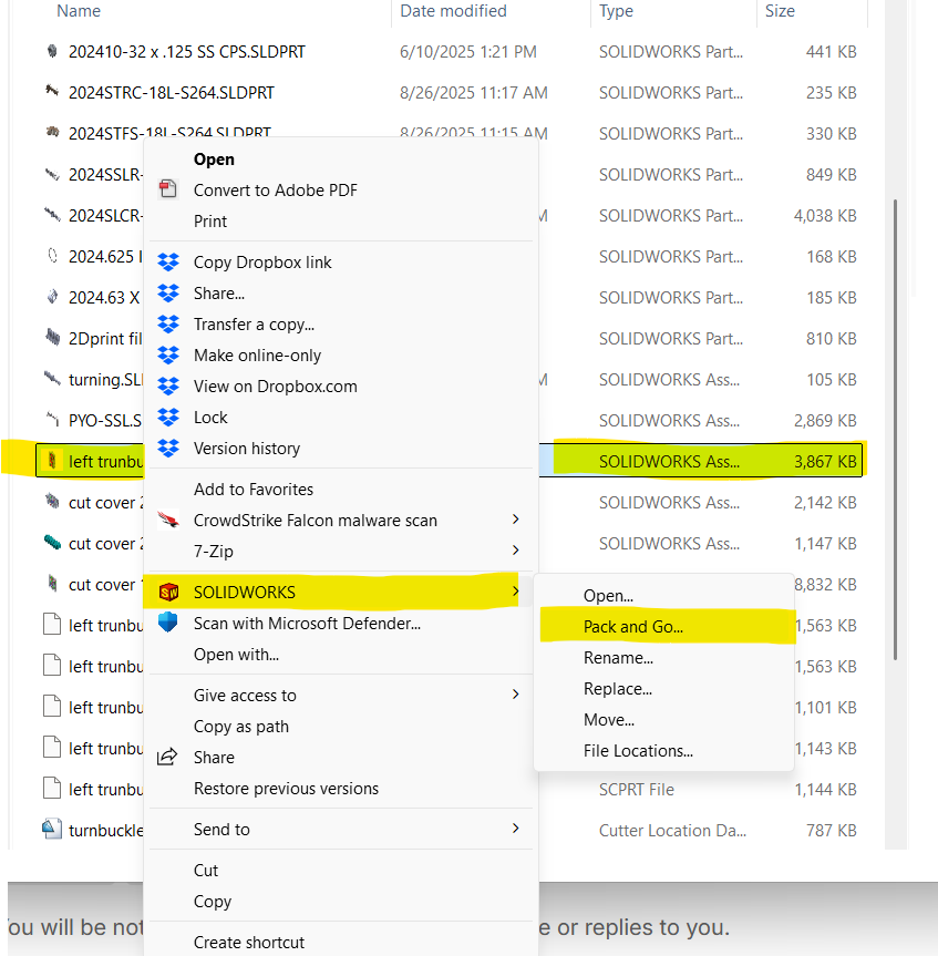

You can get it from WINDOW EXPLODER
just RMB on the assembly and go to the SW …. look at pic
thats how I’ve done it for years, no tool icon needed
