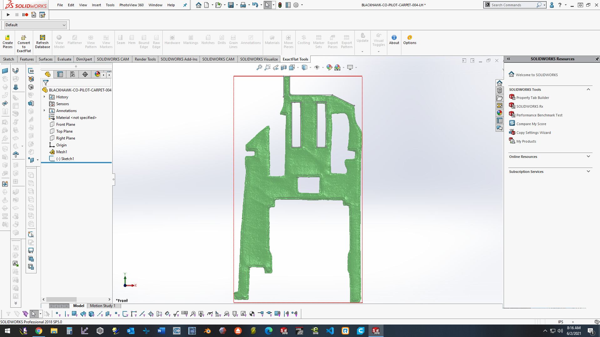

    This co pilot flooring is a good example of why I use mesh data, it saves time. I actually did a time study on how long it takes to measure and recreate manually( I used a faro arm to get point location data) vs 3d scan and create from imported point cloud. The 3d scan won by 3 hours.
  • Would you NURBS surface scanned data? In this case im not sure it would help, If I could pull a section of the perimeter off the surface then it would save time.
