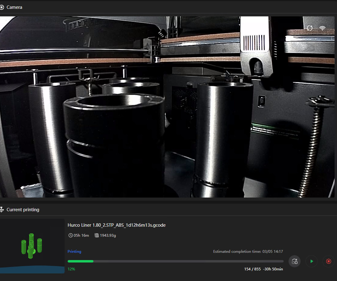

So this is disappointing. I started a 36 hour print. It looks like the firmware locked up fairly early, but the printer continued running. At the 24 hour mark it ran out of filament, and won’t respond. No out of filament error, just a stopped printer that is holding temp and doing nothing else. That’s $50 down the drain.

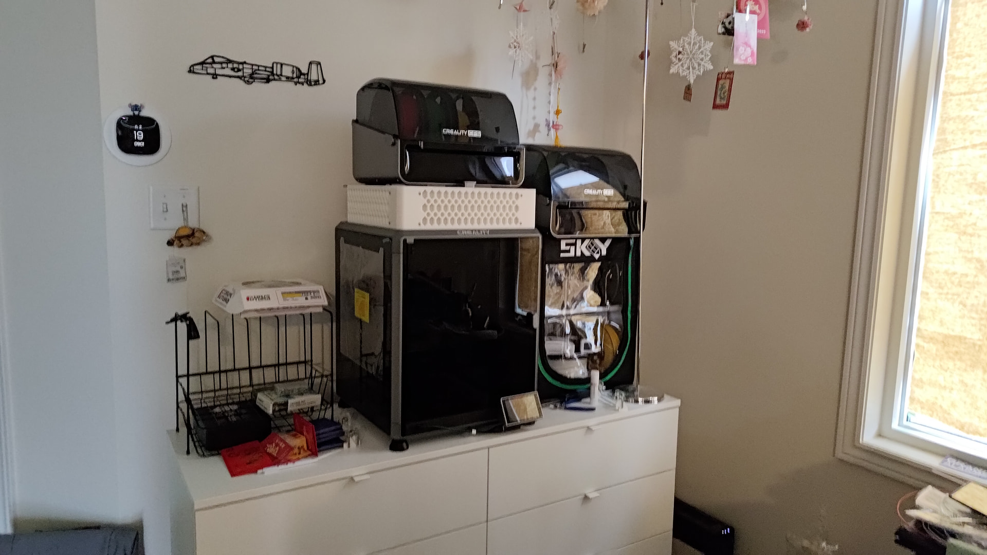

on my K1 Max, CFS and printer doesn’t work properly unless I power them on at the same time.

Creality need a few mods. CFS is not plug and play.

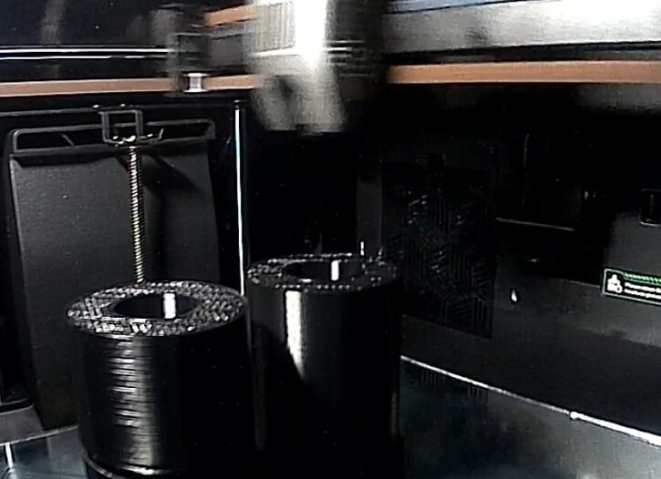

I am having fairly consistent retraction errors at the end of the print. The best I can tell these are false alarms.
The bowden tube bend is too tight in the wire chain.
Also extruder do over heat and cause random stop and error.
The more I use the Creality, the more disappointed I become. I bought the large frame printer to make large parts. Every time a print fails, it costs me a spool of material. At this rate, I would have paid for the difference in cost between this machine and a Bambu in less than a year.

Took me a month to get CFS working. No where in instruction say CFS and printer need to turn on at the same time to communicate.
My CFS is powered by the printer (K2 Pro) so that isn’t an issue.
Last night it ran out of filament, but didn’t detect that it was out, so it printed air for 8 hours.
Strange. CFS and extruder has filament sensor and both didn’t trip.

This is what I see at the end of the last few successful prints. (They have all been 10+ hour prints, so overheating is a real possibility.
In addition to the failure to retract, I’m confused by the fact that the bar says 100%, the layers show 100%, but the time remaining shows 49 minutes.
Looks like K2 got a fan blowing on the extruder stepper. See if the fan is running.
Remove extruder and check if anything in the extruder.

I’m pretty sure the filament detector has failed high. That would explain why it doesn’t change filament when the spool runs out, and also explains why at the end of the print it doesn’t detect that the filament is retracted.
