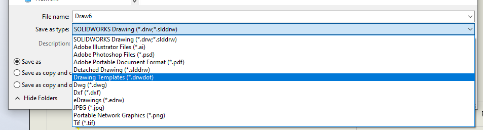

Those changes only affect the active document. If you want them to be reflected in new documents you will need to open a new document, make your changes, then go to Save as and choose “Drawing Template” (or Part Template, or Assembly Template) from the drop-down.
I’d suggest saving custom templates in a location other than the default so you don’t lose them when you upgrade to a new version of Solidworks. If you’re the only user save them somewhere else on your hard drive. If you’re in a multiple user environment you might want to save them on a network drive (or cloud location, whichever is appropriate) so other users can access them, and to maintain consistency within the company.

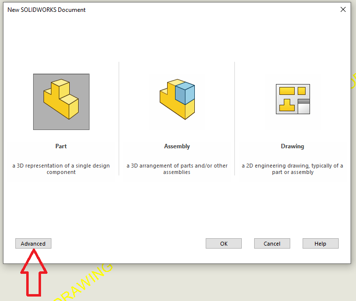

Now, when you start a new document, if you don’t see your custom templates choose the “Advanced” button . . .
. . . which will take you to a different new document window.
As you can see, I only have one Part and Assembly template, because that’s all I need, but you can have more if you need to. I do have multiple drawing templates. You might also notice that there is a second tab, “Other Drawings”, that doesn’t appear for you. I have some templates that I rarely use, but don’t want to get rid of, and didn’t want them cluttering up the main list, so I put them in a sub-folder in the folder with my main templates. Each sub-folder in the folder you’re pointing to at File Locations will add another tab. If you have multiple clients, and have templates for each, this might be helpful.
