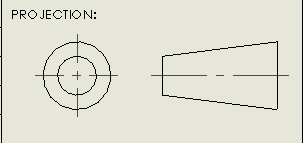

Another tip, your drawing should indicate the chosen type of projection. Ever seen something like this ?
