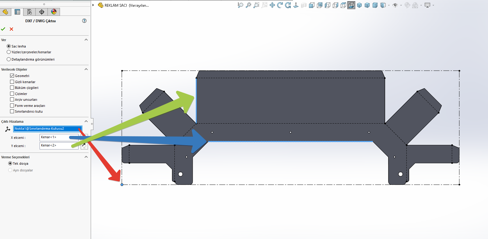

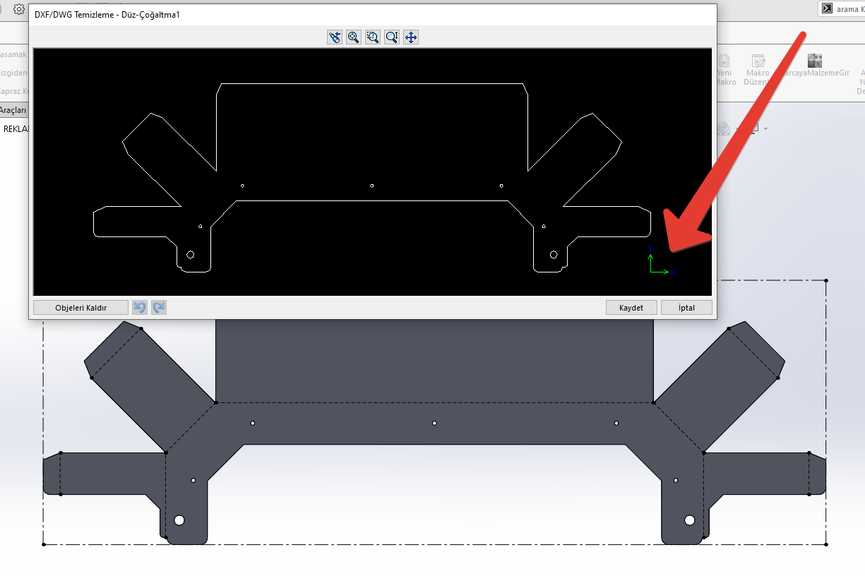

most of the time it is different from the view I set.
Is there a way to save as I set it?
To avoid to have to change DXF orientation, we sketch on the front plane, in the view orientation we prefer for the DXF, having the optional special surface of the sheet metal towards you.
I determine the flat pattern surface, there is no problem in that. (macro) .
If you pay attention to the drawing, it rotates clockwise. I want to prevent this.

Additionally, that’s not the method I’m talking about. yes, it is determined in this way and results in the correct output, but it is necessary to deal with each part individually. I am getting dxf from the assembly with the help of a macro.
Edit the “Flat-Pattern” feature. There is a “fixed” face selection you can change. This will drive the “up” side shown when exporting, yours is most likely on the back face which is flipping it over. Unfortunately, I don’t believe there is a way to control the rotation except as in the export dialogue to define an X-Y direction.
Hi jcapriotti Thank you for the answer, the face is in the right direction. there is no problem with that, i was just looking for a way for xy.
Alignment array takes care of the XYZ
then as i understand i need to start drawing by calculating yxz in order to position flat pattern correctly.
By sketching on the front plane, or importing an existing DXF and rotate this in the desired rotated angle, and extrude the sheet, we always have the desired result of side and angle in the exported DXF of the front surface of the unfolded sheet metal part. No need to do anything more.
