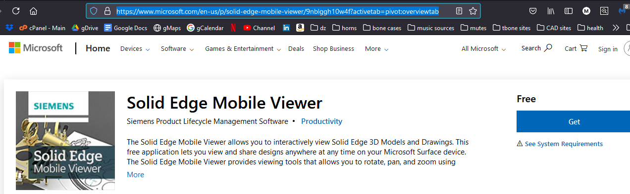

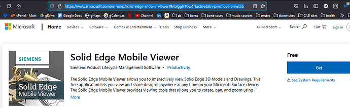

As I understand it, the SE viewer is just SE with everything turned off. I installed it a couple weeks ago, and it was a 3+ gb download.
However, if you go here: Solid Edge Mobile Viewer - Free download and install on Windows | Microsoft Store
It says there’s a PC based viewer for 20 mb.

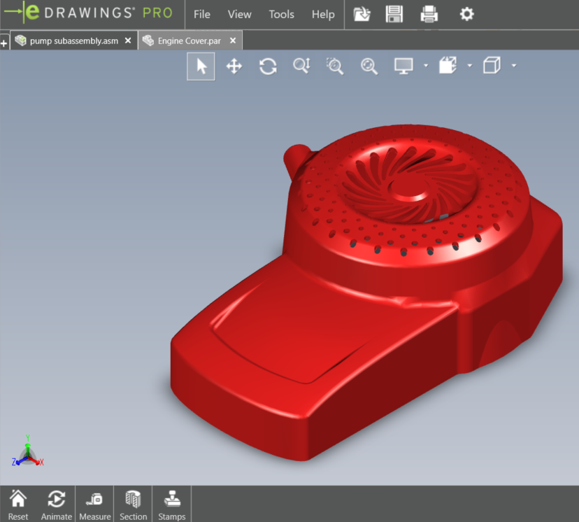

And can’t you use eDrawings as a Solid Edge viewer?
you say use eDrawings to view SE models? The compatability war rages on, eD2019 cannot read SE 2019 files
