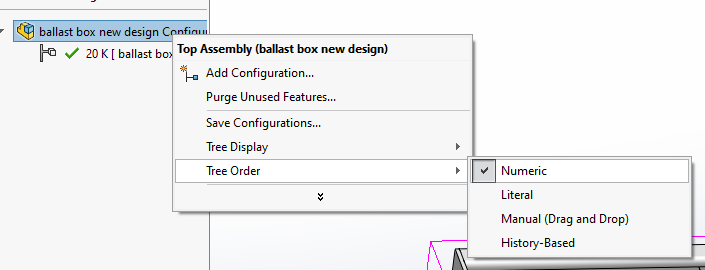

Try going to the configuration tab, right-clicking on the file name at the top, and going to Tree Order. Try out different options. If neither of the first ones do what you want (and I don’t know if they will), try the Manual option, which I know will be tedious, or add a zero in your configuration names where needed so they’ll sort correctly.
What you’re looking for is called numerical sorting.
Which sorting method happens in a File Explorer window?
Is it like your OP image?
Perhaps Windows sorting got change somehow.
Windows is numerical by default, I believe and it’s a reg edit to change it.
https://www.tenforums.com/tutorials/91417-enable-disable-numerical-sorting-file-explorer-windows-10-a.html
