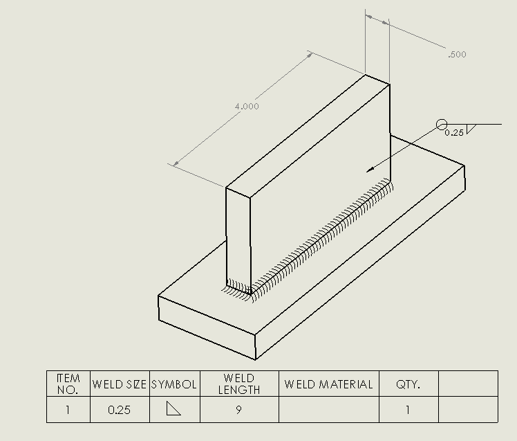

Same here. I don’t add welds to my models at all, but call out the welds in the Drawing. Some years ago I had a client ask me to add the welds in the model so they could get a total weld length. I was happy to do that, then somewhat frustrated when I realized that while that value was generated in the model, there was no way to reference it in a Drawing (or at least I couldn’t find a way).

To see the length in a drawing, you can use a weld table:
