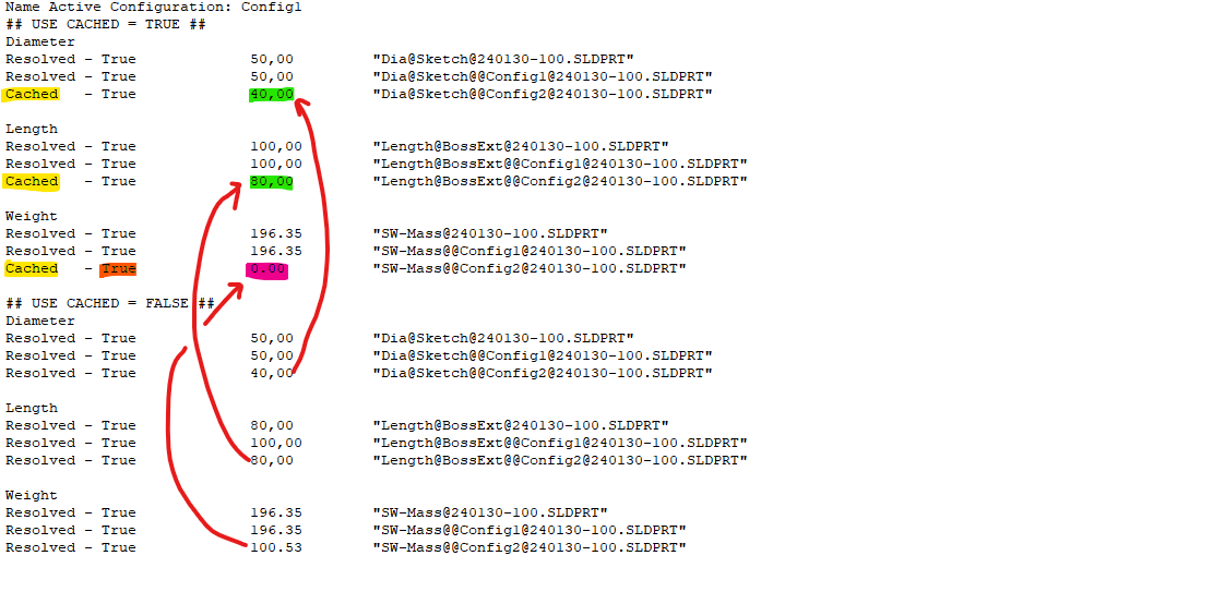

I also tried to imitated these conditions, and also got only TRUE values for WasResolved, since the value cleary wasn’t as is shown in the attached image below. Using SOLIDWORKS 2023.
Used the code below to create the resultes in immediate windows.
