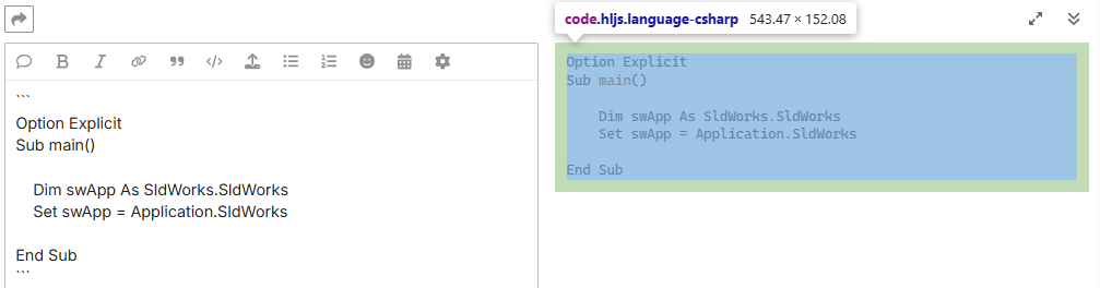

I noticed that the Syntax Highlighting doesn’t work for Visual Basic and is often washed out looking as shown in the code block below. Wonder if this could be fixed with Codeblock Theme Picker - Theme component - Discourse Meta
Option Explicit
Sub main()
End sub
Should get something like this.
Option Explicit
Sub main()
    Dim swModelDocExt As SldWorks.ModelDocExtension
End Sub
Option Explicit
Sub main()
End sub
VBA was missing from the list of languages.
Its still not showing correctly for me.

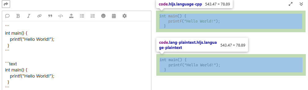

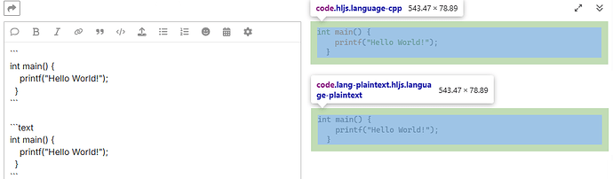

What about for other languages?
int main() {
    printf("Hello World!");

It does automatically select the language, but you could also override it by adding the language behind the ``` java|c|csharp|python|vbnet|vbscript and more, as shown in the image below. highlight.js supportes 192 languages.
The “VBA” code block in the image below is automatically marked as csharp.
Currently this auto language detection does not know what to do with the VBA language and I noticed that it jumps allot between different languages.

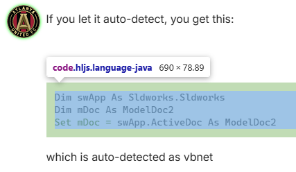

If you let it auto-detect, you get this:
Dim swApp As Sldworks.Sldworks
Dim mDoc As ModelDoc2
Set mDoc = swApp.ActiveDoc As ModelDoc2
which is auto-detected as vbnet
For me this shows up as java.
EDIT: after refreshing the page it shows up as vbnet aswel! awesome stuff Jim!
The closet you will get to VBA is VB.NET highlighting.
