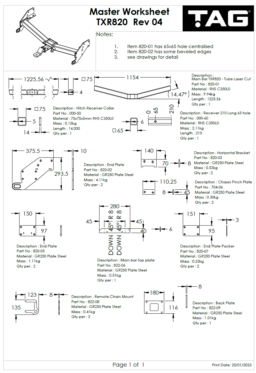

The end goal is to automatically generate a drawing similar to this:

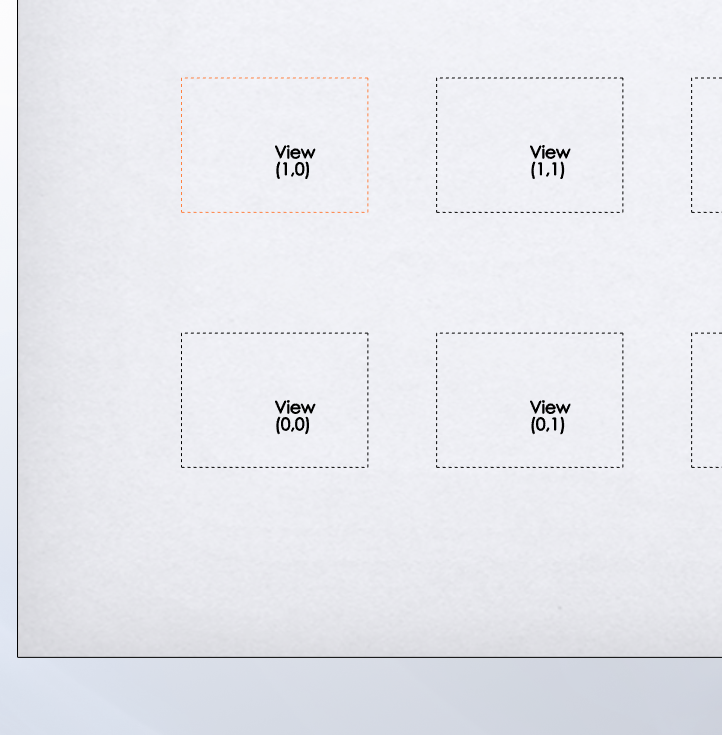

Just activate the view before you call CreateText2 to add the note. Here’s an example:
Const xStart = 5 * 25.4 / 1000#
Const yStart = 5 * 25.4 / 1000#
Const xGap = 5 * 25.4 / 1000#
Const yGap = 5 * 25.4 / 1000#
Const rowCount = 3
Const colCount = 5
Sub main()
    Dim mDoc As ModelDoc2
    Dim dDoc As DrawingDoc
    Set mDoc = swApp.ActiveDoc
    Set dDoc = mDoc
    Dim xPos As Double
    Dim yPos As Double
    Dim xCenter As Double
    Dim yCenter As Double
    Dim nextView As View
    Dim viewNote As Note
    For i = 0 To rowCount - 1
        For j = 0 To colCount - 1
            xPos = xStart + xGap * j
            yPos = yStart + yGap * i
            xCenter = xPos + (0.001 - xPos) / 2#
            yCenter = yPos + (0.001 - yPos) / 2#
            Set nextView = dDoc.CreateViewport3(xPos, yPos, 0, 1#)
            dDoc.ActivateView nextView.Name
            Set viewNote = dDoc.CreateText2("View (" & i & "," & j & ")", xCenter, yCenter, 0, 0.125 * 25.4 / 1000#, 0)
        Next j
    Next i
End Sub
