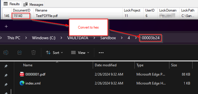

The original SOLIDWORKS PDM File Version Upgrade Tool will save a .bak file into the archive server folder (0~F) with the HEX value of document ID as a filename. For the moment I do not want to write the archive server disk, but I would like to create a folder named as the PDM DocumentID on the TASK machine desktop and save the backup file inside it.
Is there a way to get the DocumentID from a VBA PDM TASK script?

The ID within the sql server is the same as the IEdmFile5.ID property. Convert this value to hex and you have your folder name.

Thank you! IEdmFile5.ID property is what I was looking for to get the file ID.
https://help.solidworks.com/2023/english/api/epdmapi/EPDM.Interop.epdm~EPDM.Interop.epdm.IEdmFile5_members.html
I have already used the Document ID outside the macro world to recover some cold storage file.
After DEC ->HEX conversion the last digit of the HEX ID is the archive server folder name in which the file resides.
Now I have to figure out how to backup and rename that file outside the vault, so I could checkout and edit the one inside the vault overwriting the latest version like the FVUT. And properly log every operation. =)
