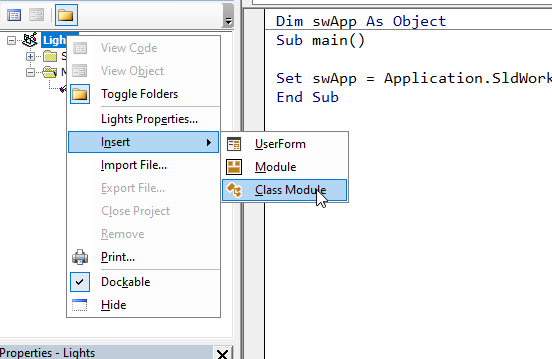

To add a class module:

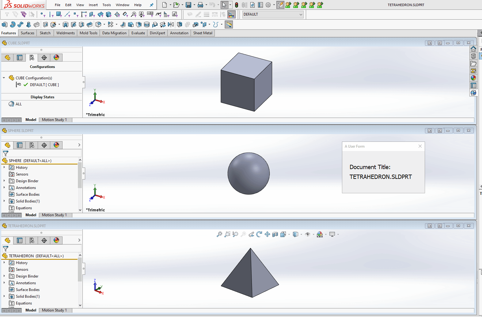

Any time the active document changes (switching windows, opening/closing documents) , SOLIDWORKS will call the swApp_ActiveDocChangeNotify function.
Every time a document is closed, the corresponding DestroyNotify2 function will be called. The only reason the example code is listening to the three DestroyNotify2 events is so that if no more documents are open, the user form can be updated to say ‘no active document’. Here’s an animated GIF showing it in action:
SLDWORKS_RwYC7OAJHU
