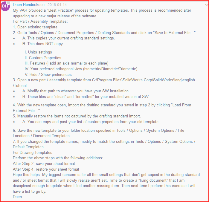

Here is some reading material:
https://r1132100503382-eu1-3dswym.3dexperience.3ds.com/#community:yUw32GbYTEqKdgY7-jbZPg/post:OYb_H2AZQ5OPPwoKyMKKAw
And this especially:
https://r1132100503382-eu1-3dswym.3dexperience.3ds.com/#community:yUw32GbYTEqKdgY7-jbZPg/post:EEliAVDQRH2d_O0KiQALTg
