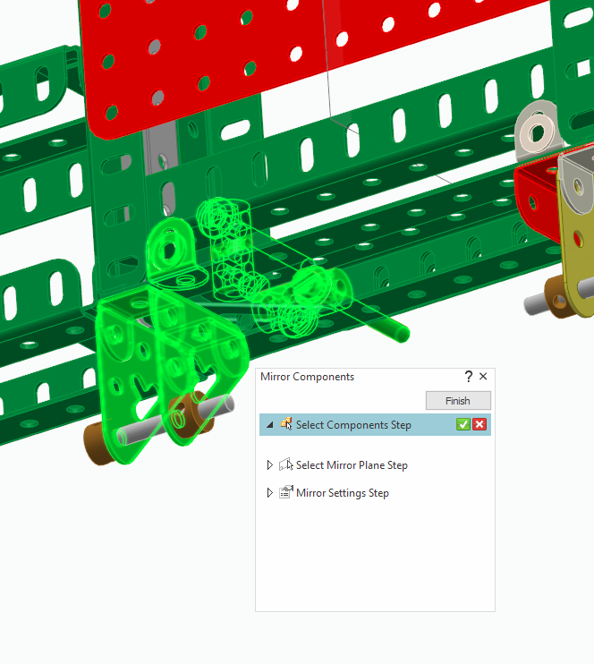

How do I unselect parts to mirror in an assembly? I was just suppressing the parts put the pop up bar that contains the suppress icon stopped appearing.

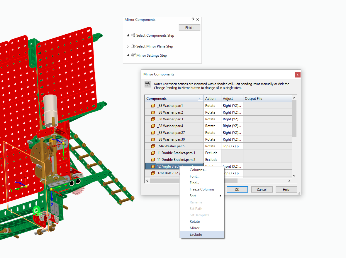

I found a way. Under edit Mirror, Mirror Settings Step. Right on the component and select Exclude. I would be more intuitive to be able to graphically unselect the components.
Hold down the CTRL key to unselect an already selected component when you are in the Select Components Step.
Thank you. that makes things much simpler.
FYI, that goes for any feature that involves selecting items. It’s kind of nice because then you don’t accidentally deselect items, but it’s not very intuitive. It took me a bit to discover that nuance.
