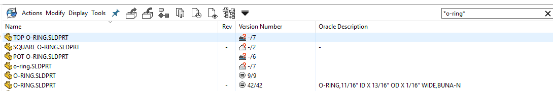

I don’t much about API stuff. But some of what you show for PDM developers overlaps with the PDM user search, which also has a history of poor documentation. help.solidworks.com search info
Wildcards is one aspect you may want to clarify, it trips up many PDM users, because it’s strict about interpreting wildcards.
User PDM search: *o-ring
does nothing. [assuming files like “Viton O-Ring.SLDPRT”, or “O-Ring: 262, 6.984 ID”…]
You can’t truncate/simplify, must add asterisks before and after your search word (or put the exact ending and include the file extension).
Search: *sldprt - works because it’s a file extension, so no text is after it.
Yep. You need the trailing ‘*’ as well.

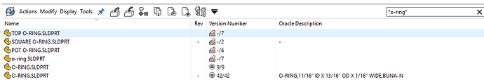

Users have to be trained that PDM search does not work like windows search. Quick search can help, because you can tell it which variables to search. I have mine set to search file/folder name, part(Oracle) number and description:
If this doesn’t capture every o-ring or o-ring related file, then there are larger problems in the PDM data.
