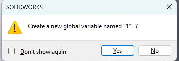

I am hoping this is a toggle I somehow activated, I use to be able to go into a metric united model and type in a inch dimension with 1.0” and it would update, all of a sudden I get the following:

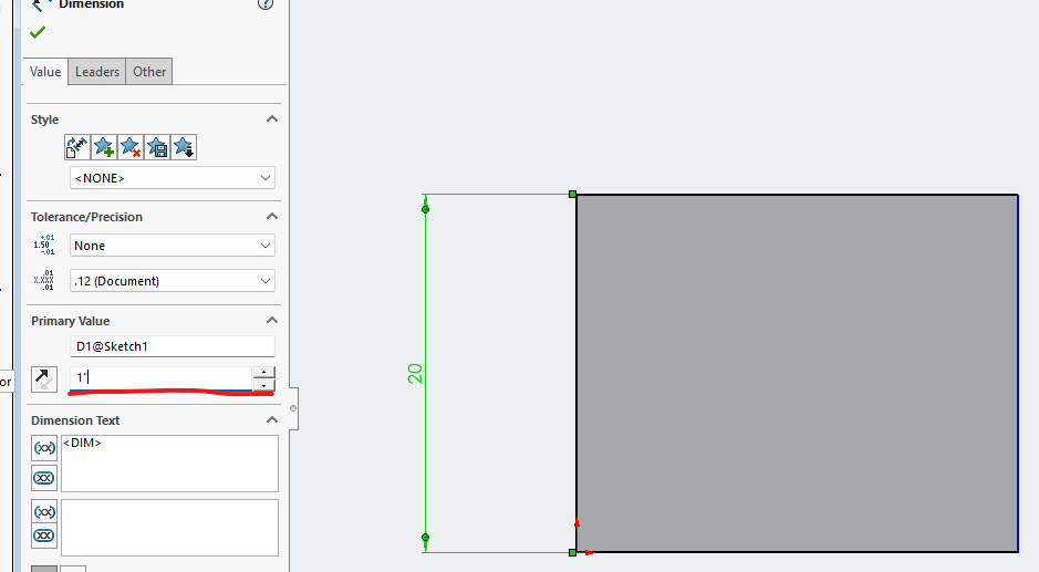

hi agai,
here you go:
typed in 1”
and its stuck, so not sure what’s up
I found it is making equations never seen this before or how to turn off

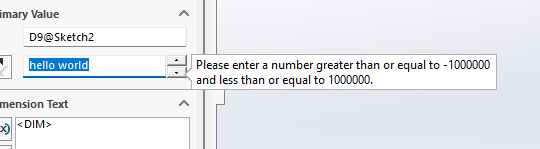

What happens if you enter msgbox(“Hello World”) into that box? Do you get this?
Note that once you click “OK”, the dimension will get the value of 1.

I can type in the dialog on the left,
typing in the box 1+2 turns to 3 on both,
1” does turn into 25.4 only after I close or green check the dialog on the left
hello world gets this:
and this:
