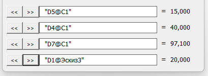

I’m not as skeptical of AI as many here :pinched_fingers:
Writing code completely mindlessly doesn’t work right now. But I use this method for simple macros, either entirely or for modules:
I write a very detailed prompt. It’s not like, “I need a macro that will establish an equation relationship between two selected sizes.”
I describe in detail which functions need to be used to obtain the “size path” and write the equation.
And once all this is done, the code works, even on the first try.
*I made the form myself, placed the Controls myself, and immediately described their names, what they do, and how they react to events in the AI ​​prompt.
Here’s a specific example of how I wrote a promt for this macro:
Solidworks VBA macro. I have a form called FormDim with ShowModel = False. After running the macro, it immediately displays and remains open until it’s closed. The user continues working in the Solidworks shell, occasionally accessing the form to perform the macro’s functionality. The form has four control groups, with the description of one group being:
Button CB_ADD1, Button CB_GET1, Textbox TB_WAY1, and Textbox TB_VAL1.
The other groups have indices 2, 3, and 4.
When the CB_GET1 button is clicked, if a dimension is selected in one of the Solidworks programs, the path to that dimension (e.g., “D1@EJEKTOR”) is copied to TB_WAY1, and the value of that dimension in mm is displayed in TB_VAL1.
When you press the CB_ADD1 button, if TB_WAY1 is not empty (e.g., “D1@EJEKTOR”) and a dimension is selected in one of SolidWorks, an equation is created for the selected dimension’s value, which is set to the value in TB_WAY1 (example: =“D1@EJEKTOR”).
If you click TB_VAL1, TB_WAY1 is cleared.
Here’s part of my code from another macro for finding the name of a selected dimension:

When you press CB_ADD1, use .GetEquationMgr to get the equation manager and create a new equation.
