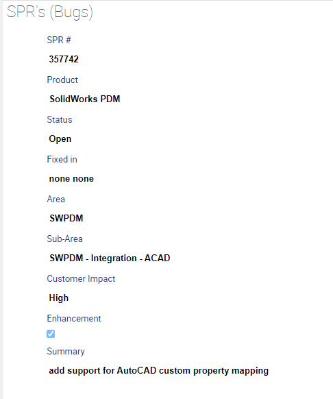

Just wanted to update:
Now, my plan (well, my hope) is to create an add-in, utilizing the installed AutoCAD dlls, to get and set DWG custom properties via transitions and data card buttons, respectively. This seems like a pretty workable solution, and will hopefully not hurt the team more than it helps.
The biggest issues I foresee are:
  • Doesn’t work like I plan
  • Navigating Autodesk’s API development guides
