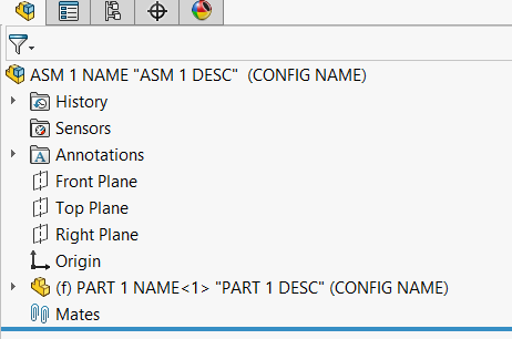

Here it is in 2020.
It is very easy to distinguish between the part name, the part dscription (in quotes) and the configuration name (in parenthesis.)

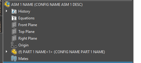

Here it is in 2022.
The config name is now in front of the part description, with no way to tell where one ends and the other begins.

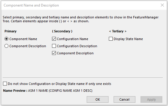

This is the new dialog associated with it. They need to make “Configuration Name” an option under Tertiary.
ETA: It appears there is a bug where instead of showing the part description it shows the part name again.
Super annoying, and for me the sequence makes no sense.
I would suggest to put the Configuration Description under Tertiary as well.

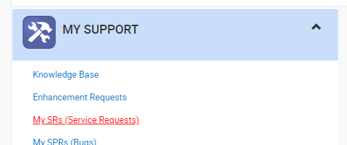

You should be able to find that SR by going to Customer Portal > My Service Requests
We’ll only be able to vote on it once it has been converted to an SPR.
Not to mention the nonsensical behavior of the checkbox for ‘Do not show Configuration or Display State name if only one exists’. It ties the two together for no reason. With the box checked, if you have two configs but only one display state, the display state name is still shown. One config and two display states? Go ahead and shown the config name.
The checkbox should be labeled ‘Do not show Configuration or Display State name if and only if one of each exists’.
What developer or QA person tests this and says: “Yep! That’s working exactly as it should!”.
