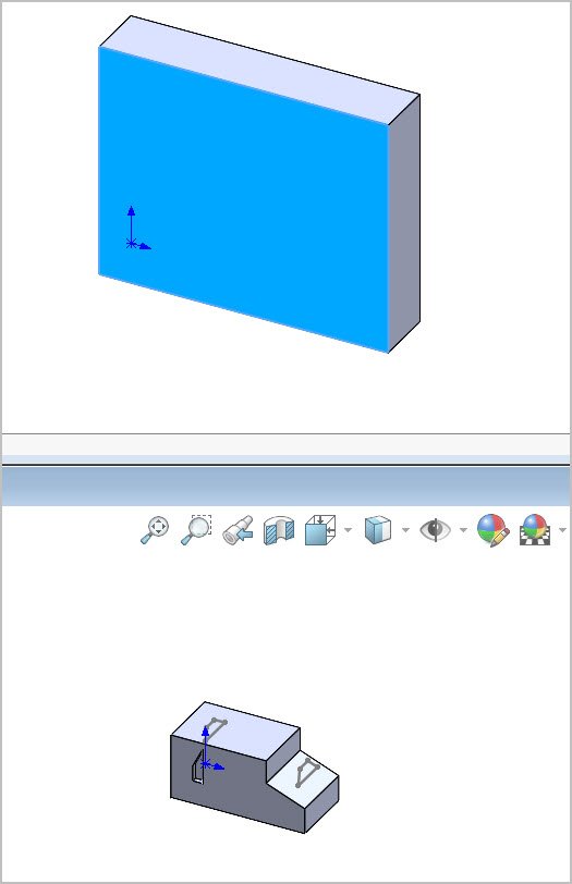

What it doesn’t do. I tried having 2 part models open simultaneously & tiling them. If I repeat above but select a destination face in a different model, the Derived Face function is greyed out. I guess that makes sense otherwise there would have to be some kind of behind the scenes link between the part files. So alternatively I have used the Ctrl-C (copy) & paste into new file sketch. But its totally flexible at that point so you have lock or redefine the sketch relationships.

No I suppose it won’t allow you to derive a sketch from one part to another, but if they are in the same assembly, and you do it within the assembly, it will allow you to use derived sketch to place that sketch onto another part.

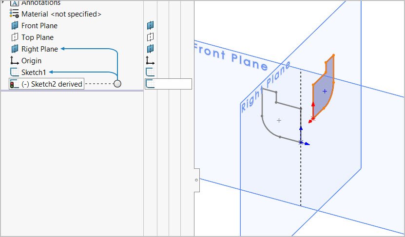

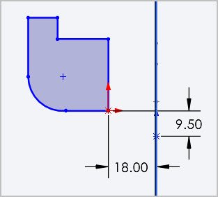

Well I don’t know what I was doing incorrectly before, but it turns out I can use Derived Sketch function to copy/transpose a sketch to any other plane, thus creating a new sketch. I was able to transpose to a part face but that’s just an additional capability. When its first inserted to the target plane, the entities are all blue (undefined) because the group is not yet referenced to an origin point or whatever. However it does preserve the sketch entities between each other, kind of like a group. You can lock the sketch into a desired position by dimensioning or alignment. Where I was getting confused is the new sketch does not then turn black indicating fully defined. But I think that is SW way of saying its not, really. Because if the source sketch changes, then the derived sketch updates accordingly. Totally useful. This method saves some copy-paste clicking like I was doing before.

Actually it should change to black. I’d say you’ve just not defined the rotation. Put a constraint to make it parallel and it should go black (to check prior to this… grab and drag a point on the sketch entities and it’ll rotate most likely).
In order to have it fully defined, you just need to lock it down. Lock down rotation and location. Basically it is like locking down a block.
