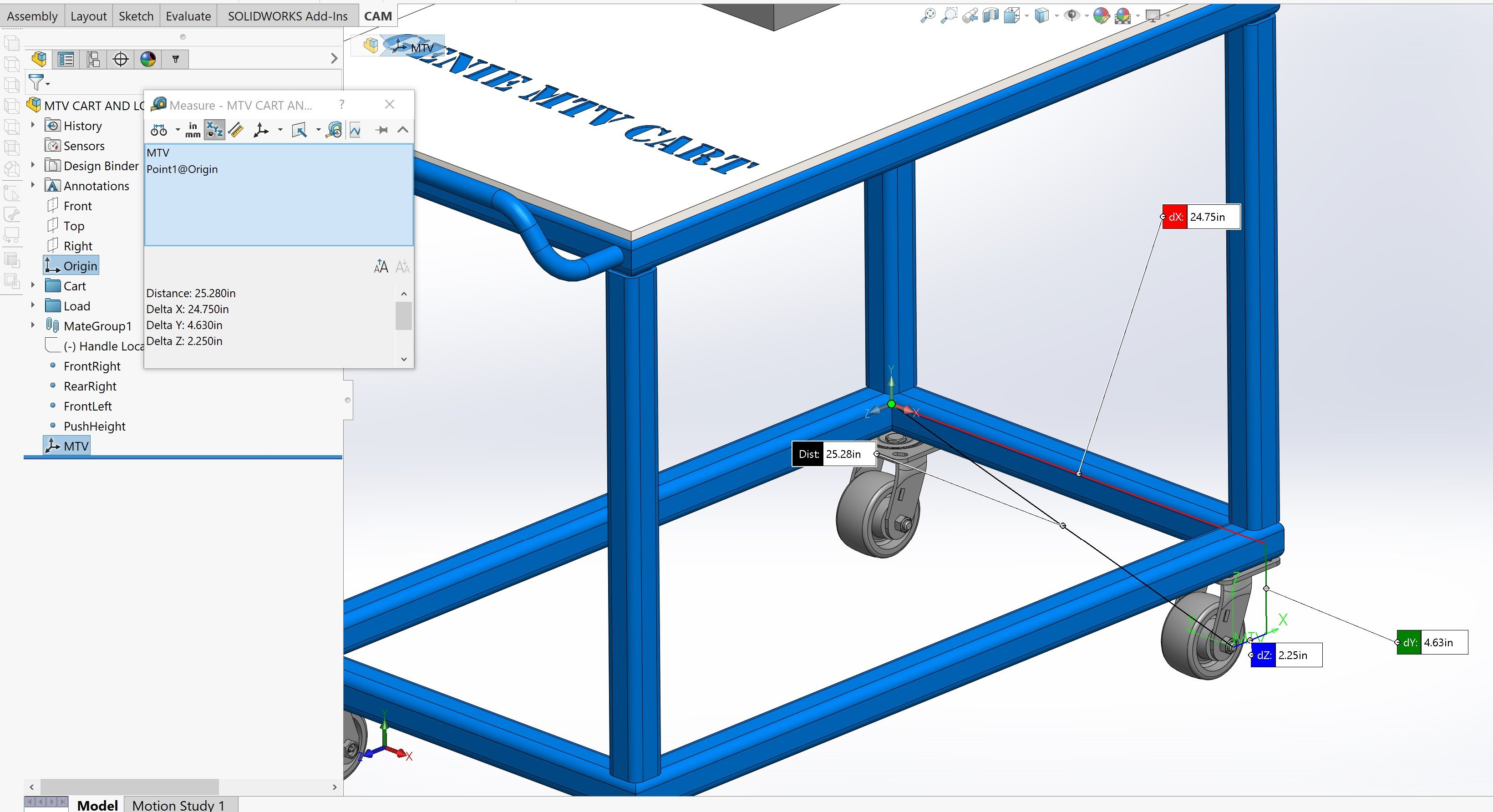

I am having issues transforming the XYZ assembly coordinates of a point to be relative to a reference coordinate system in the assembly. Users of this macro will build their assemblies in any orientation, however, the reference coordinate system will always be oriented the same way so it would be helpful for further calculations to translate the points.
I have already calculated the Transform Matrix for the reference coordinate system, and found the XYZ coordinates of the points I need to convert, but when I try and use the .MultiplyTransform function, the new values it gives for the points are not correct.
The reference coordinate system “MTV” is located at the point “FrontRight”, so the new XYZ values should be 0, 0, 0. Instead I am getting 0.05715, 0.62865, 24.867602.
Image of the Origin Coordinate System and the MTV Coordinate System:
