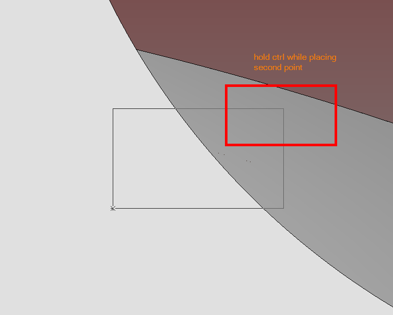

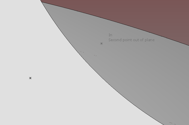

this one goes back to the delcam forum, some user called NRGworks posted this & it was a game changer for me.

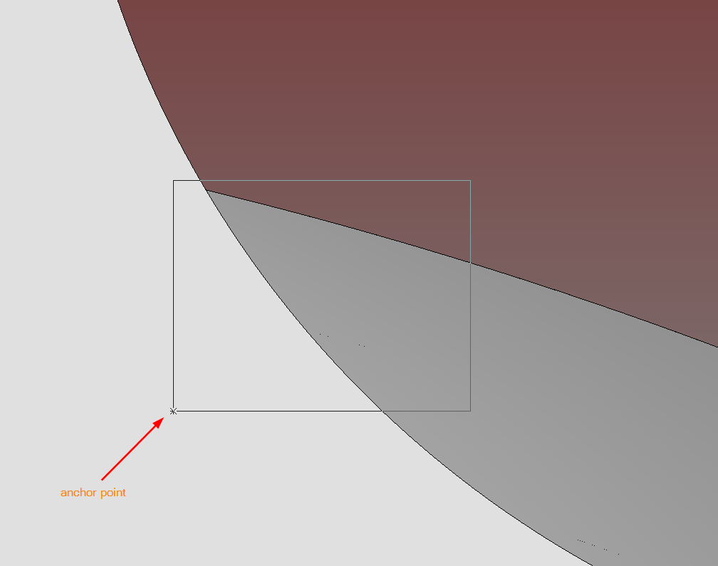

When in curve editor (boundary or pattern) sketching a rectangle, if the second point falls out of the same plane as the first point, hold ctrl when positioning the second point and that’ll keep it on the same plane as point 1

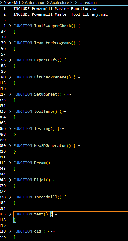

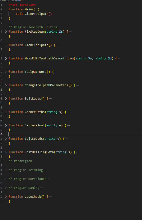

i have a generic macro on the ribbon, and i keep it open in my text editor for stuff that i do often enough, but with small differences. i change the name of the function i want to call in the main() and if anything needs changing, i fix it in the respective method.
I have the exact same thing lol. Change the one I need to Main and use ALT + 5 to execute it.

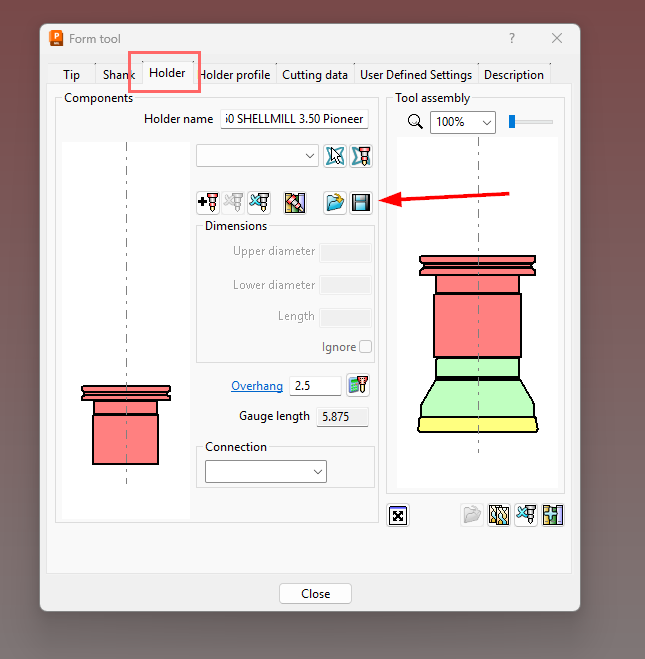

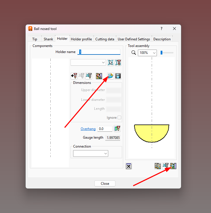

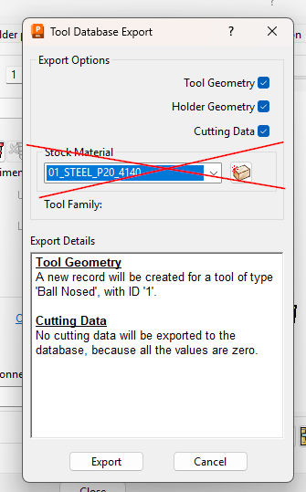

Good morning, I am trying to figure out how to add 3/8” and 1/64” cutters to my tool data base in powermill. How do I go about doing this using my same modeled tool holder and extension? Any help would be greatly appreciated.

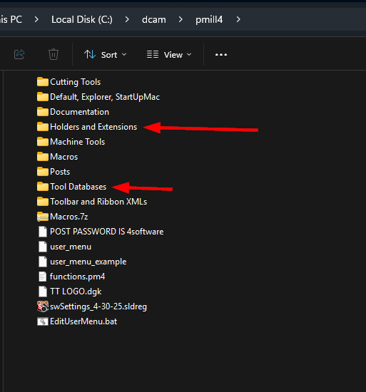

Activate a tool that has the holder you want to save, then go to the holder tab and save the holder. Personally, i keep everything in my c:/dcam/pmill4 folder. Make a folder for Holders & Extensions, save the holder/extension there.
now create your new tool. import the shank/holder using the folder next to the disk. After that you can add it to the tool database. dont worry about the stock material setting.,.. I’m assuming you have a database set up?
